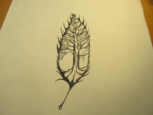

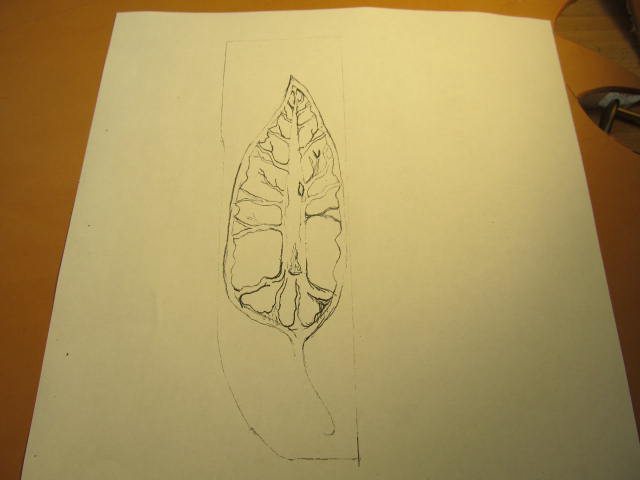

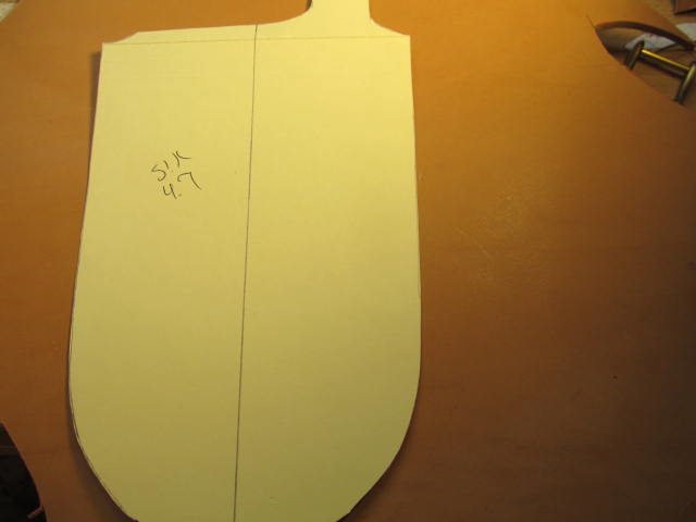

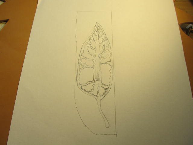

Making a sheath for a Survive! 4.7. Just covering the prettying up part of it. A friend of mine with much more artsy sense than I do drew this up.
The pattern on manilla.
Drew my own interpretation of the drawing, considering it has to go on leather. You do not have to be an artist to do this stuff, obviously.

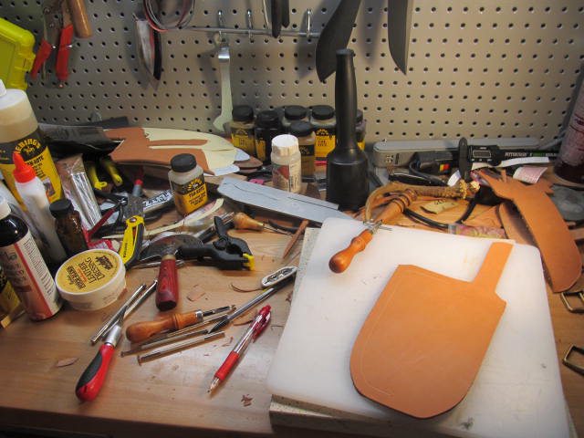

Make a photocopy.

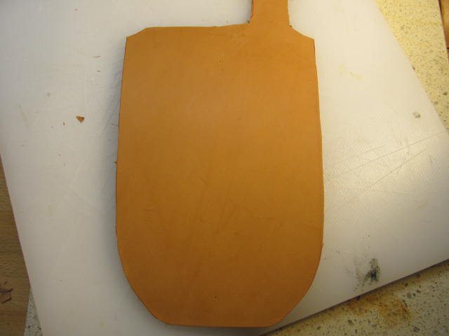

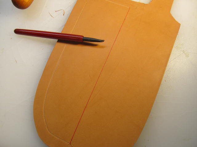

Sheath blank.

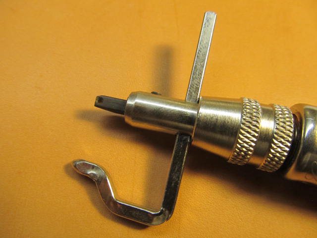

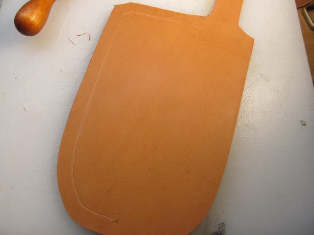

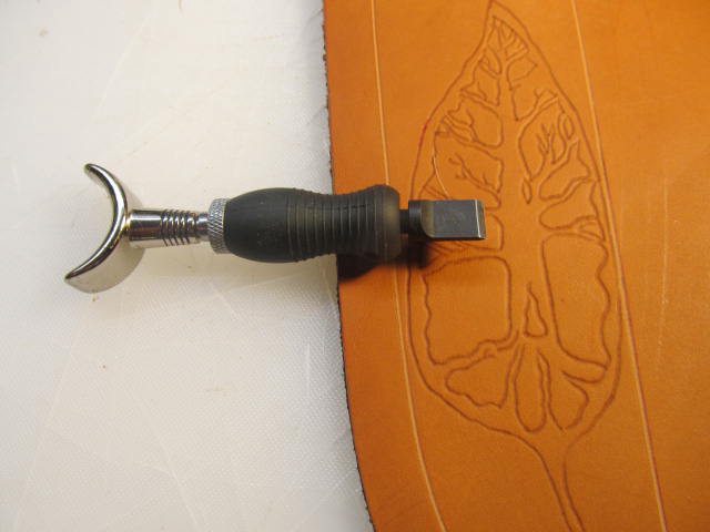

Set the adjustable stitch groover for about 1/2" and mark a border.
Rejoice in your orderliness.
DON'T cut past the halfway mark.
Cut the middle line.

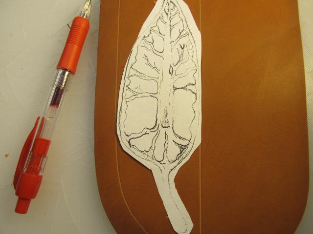

Photocopy that thing.
Don't cut tight to the pattern, you need room to mark the outside.
Wet that leather, go have a drink, smoke, or both.

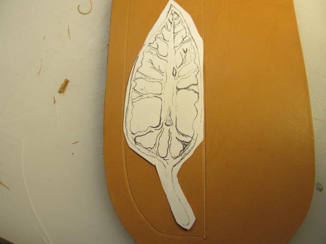

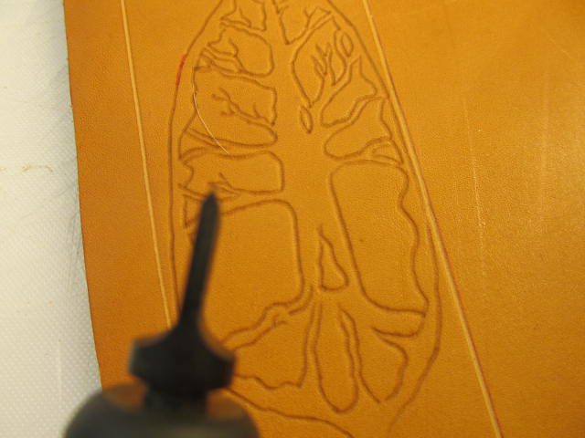

Lay it out, prep your trusty red pen.

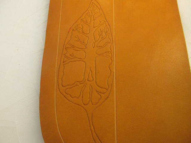

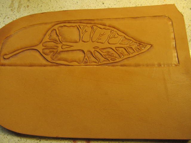

Trace over your pattern carefully.
Somewhat tree like, win!

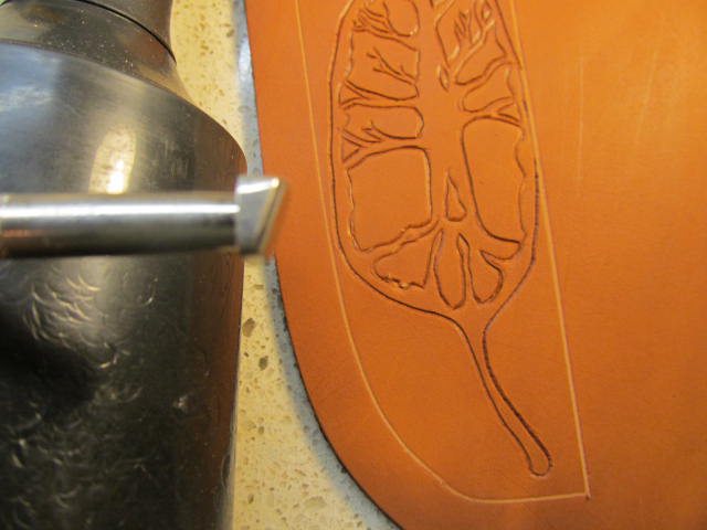

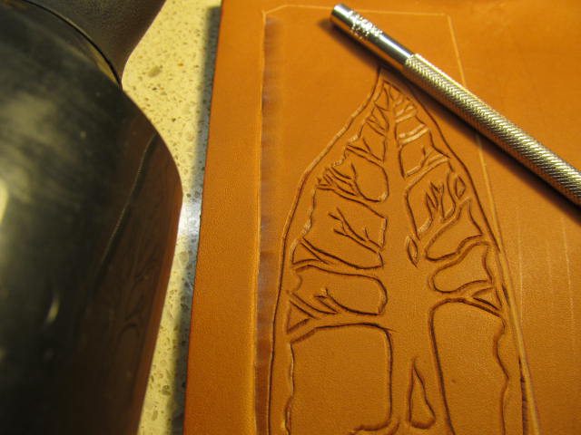

Cut your lines in with the swivel knife.
Cutting away.

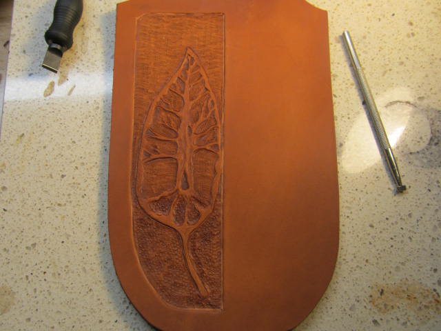

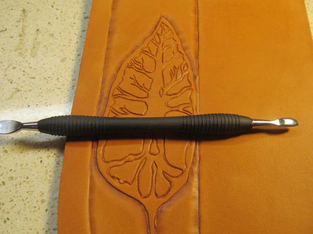

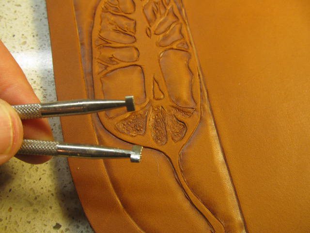

Time to start beveling. Using a smooth bevel stamp.
In progress.
Your beveler won't get into all the tiny little buttcracks, you'll have to use your molding tool a lot.
Like so...
Exteriors beveled.

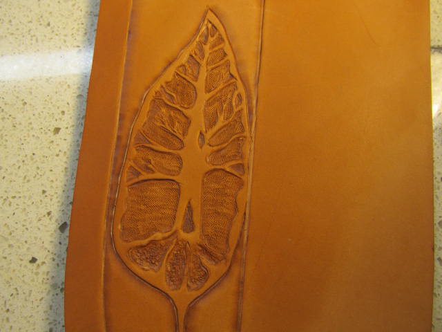

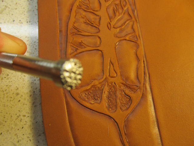

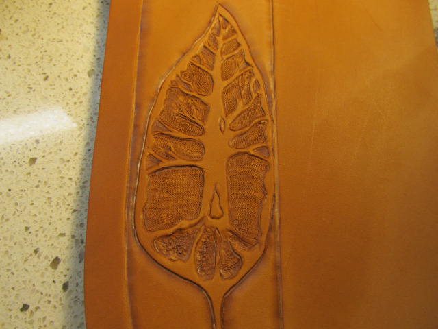

Breaking out the pebbled background stamp.
Yes, these guys suck to use as much as you'd think they do from looking at them.
Interior done'ish.
Moar done'ish.

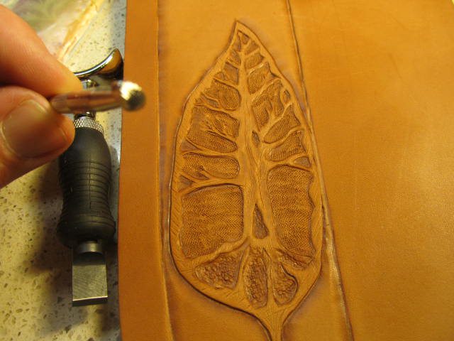

Veined pear shader and a lot of tiny little swivel knife cuts.
Go go pebbled backgrounder! Love it.
Wet and ready, oo baby.

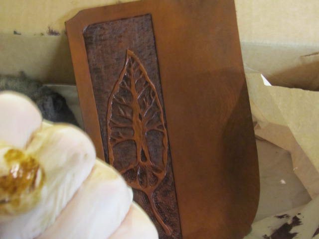

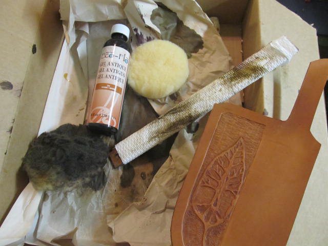

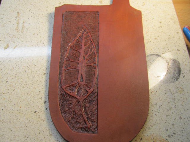

Antique gel, sheepskin type stuff for spreading it, and a paper towel wrapped around a ruler to smooth the top out.

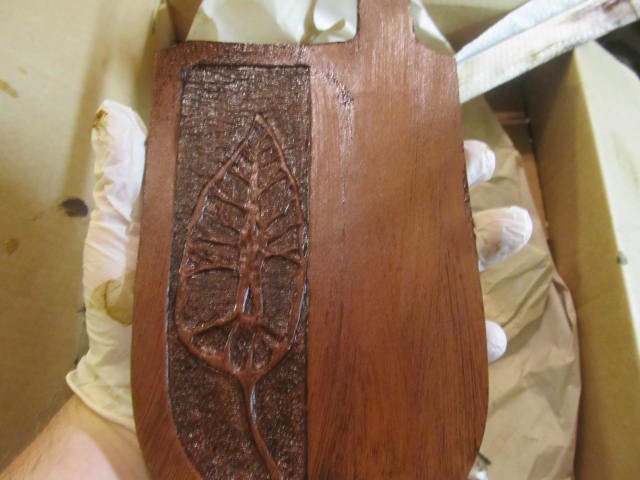

Me = Over the moon!
Dressed up.

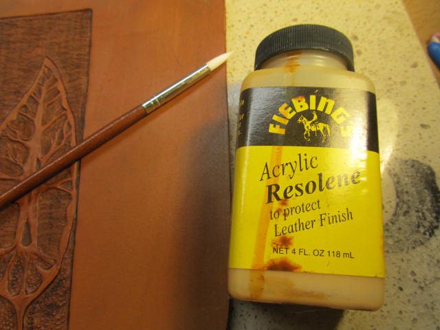

Acrylic finish, it will seal whatever you drop it on, be careful!
Acrylic'ed up.
Time to see if that stuff works, dark brown dye.
Yeeeessssssssssssssss....
Dropping the acrylic resist in the wrong place can ruin your piece. Contrary to sensibility, it's best to use a good brush (I bought some paint brushes from Hobby Lobby) and load it down, it seems to leak less loaded up than when you don't put much on there.

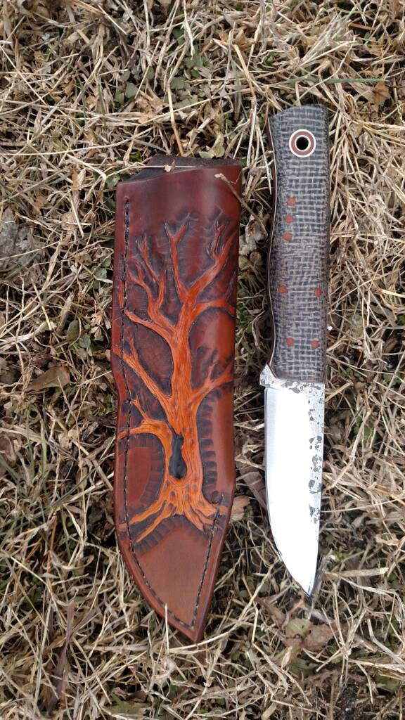

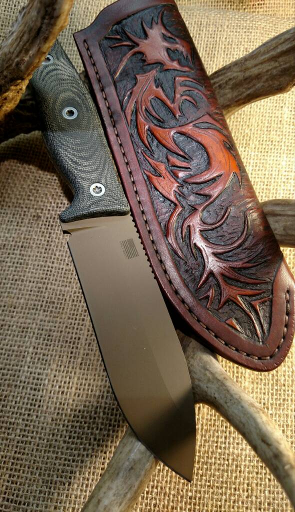

Liking this the best so far. This sheath has a depth to the carving that was missing from your earlier work. Good job that is one of the characteristics that separate good carving from carving. Your bevelling is getting more adept too, curves are curvier. Real nice!
Thanks for the nice words. Horsewright, that made my day to hear. I was definitely more tentative with the maul when I started, repetition has made me a bit more assertive with it.
Sent from my XT1254 using Tapatalk
Lot of it is getting your casing right. That comes with experience too. Just keep hitting them tools with that maul.

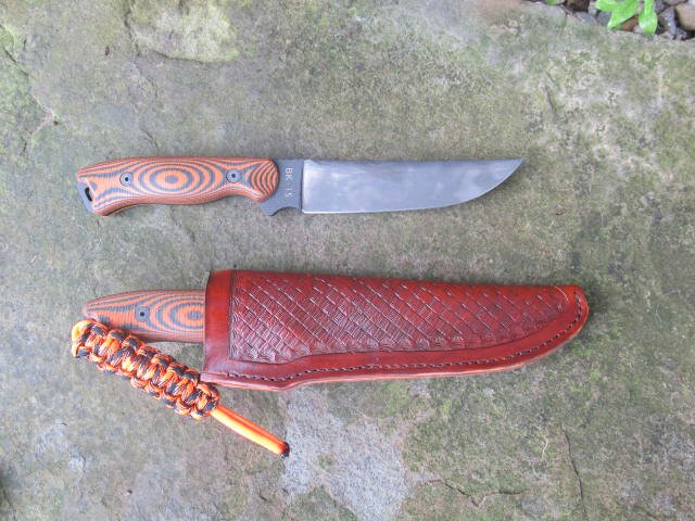

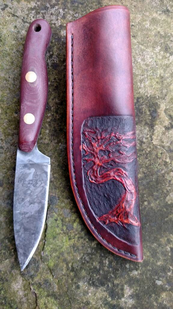

Survive! 5.1 sheath
Carothers Field Knife
Carothers EDC
Carothers EDC and Light Chopper.
A couple are not carvings obviously, the Light Chopper was a fun tooling/carving time.

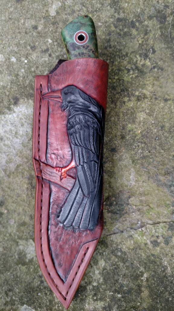

Wow your work just keeps on improving! Compare this basket stamping with the sheath next to the pup. Good deal! See I told ya keep hitting them stamps with the maul. Good stuff happens. That one for the light chopper needs to be done for a knife with a worm groove handle.
Thanks for the kind words. Horsewright, that was exactly the handle type I had in mind when I did this one, that knife is beautiful.
The Light Chopper sheath was meant to just be a proof of concept thing to make sure it fit well but I thought I'd knock something out quick with a molding tool. 3 hours later and with a bent molding tool and varying pear shader lines, voila.

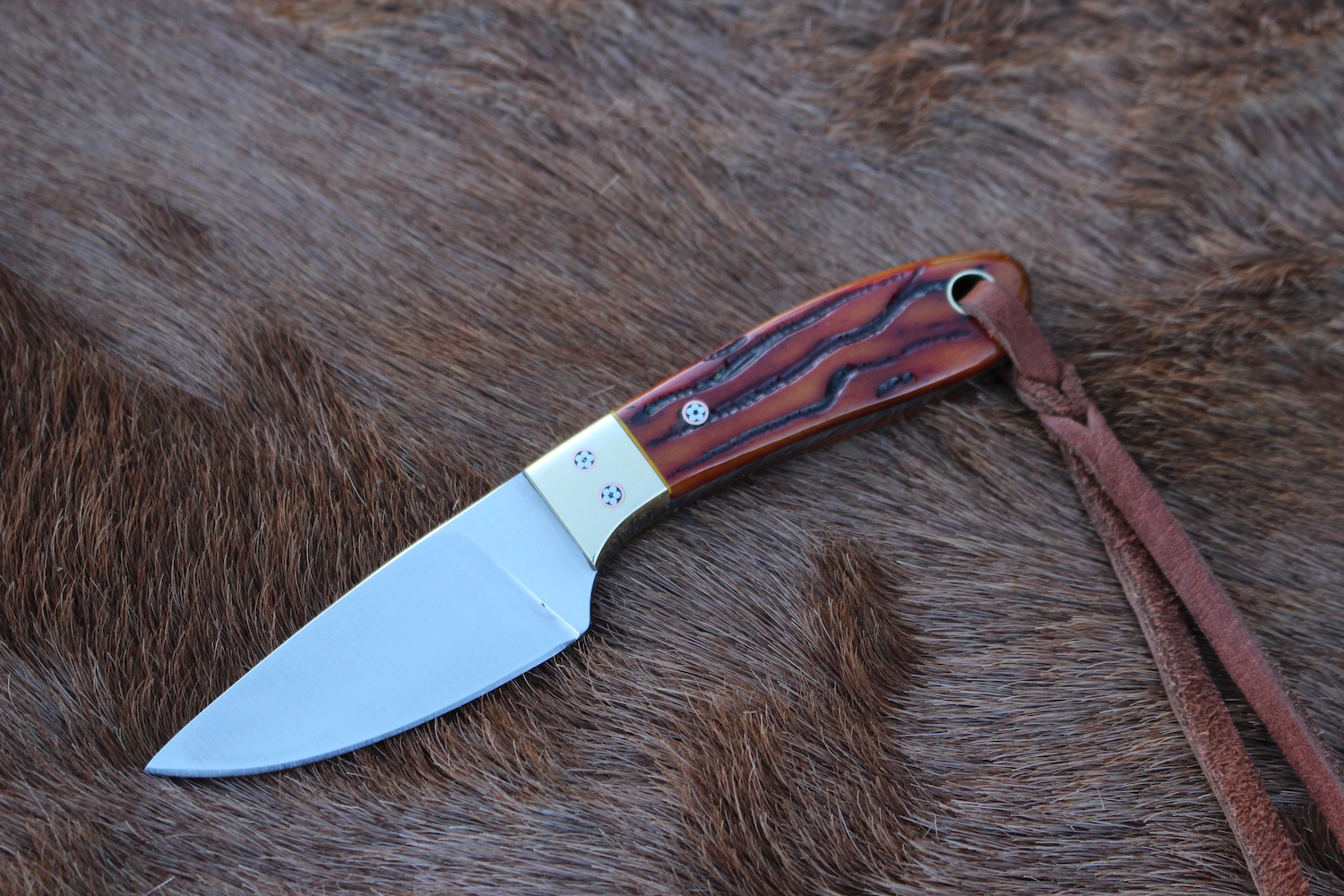

Thanks. Thats a Poco, only about 5" oal. Poco is Dave spanish for not enough steel left over to make a regular sized knife. Mostly I make em out of damascus but this time had a little bit of AEB-L left over.

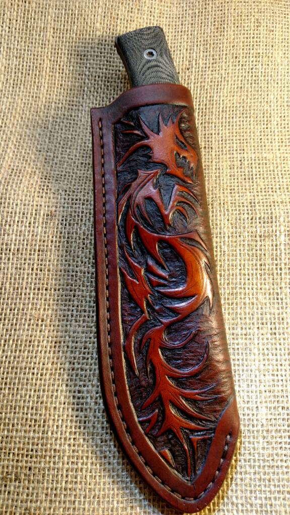

Finished and shipped my first 'set' of carved sheaths today. Kinda sad to see them go, it's taken a while to finish. Carothers Performance Knives Light Chopper, Field Knife, and EDC.
Light Chopper sheath. I didn't see this big of a coloration discrepancy in person between the sheath and dangler, I think it was partially lighting and partially the difference in the way the antique took to the different tooling types. 'Best' is subjective but if I was grading myself, this was the best.
Field Knife sheath. By far the most technically difficult, lots of tiny bevelings and demarcations.
The EDC, my favorite by far. The others are very structured, this one is very fun to me.
