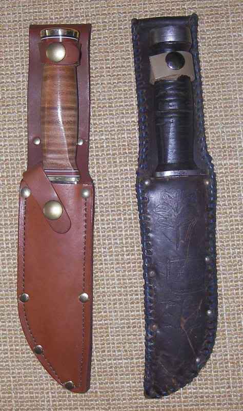

I see two primary approaches in leather sheath design.
1) fold the leather against the blade spine to make a pouch then zip up the other end.
[My own first, crude but quite serviceable sheath, done this way a few weeks ago..]
2) cut two (three if we include the welt) pieces of leather to fit, then sew them together.
[As done here]
Here's my question. The first way is easy and fast. Still I see most of the factories and many custom sheath makers doing it the second way. I have several more knives needing sheaths and will make some soon. What, if any, structural or durability advantage is afforded by the second method?
