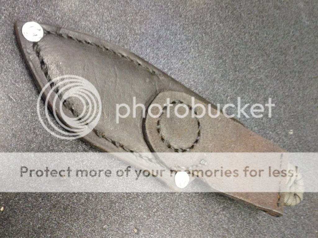

I just finished my first leather sheath, well ok its not my first. The first couple attempts landed a home in the trash! This is the first finished one that I feel ok about. I used 8 to 9oz leather, waxex thread, silver rivets and dipped in paraffin wax. I was a little iffy about the wax dip but wow does it stiffin up the leather!
I cant seem to get a good picture of it but here it is...
If you can see where the stitching stops at the top left of the sheath, I continued the welt that high so it catches on the little finger guard the 11/14 has. The knife feels like it clicks into the sheath and it holds it very nicely. This sheath is also meant for a knife that has a wrapped handle or scales.
Let me know what you think because tonight I am going to try and do this over, paying more attention to detail and adding a loop for fire steel and maybe a loop for me Fenix E01.
Thanks for looking.

Hey Goose that means a lot coming from you! Any suggestions? I know the picture is bad.

CBwoods, I am in the Gurnee, IL area. And I should have been clearer about the wax, I actually didnt dip it. I heated up the leather and then brushed the wax on, so not much made it in the inside of the sheath.
Yeah for sure, it's a really nice design!! I like how it's got a taco/pancake look going on. Very cool!! :thumbup:

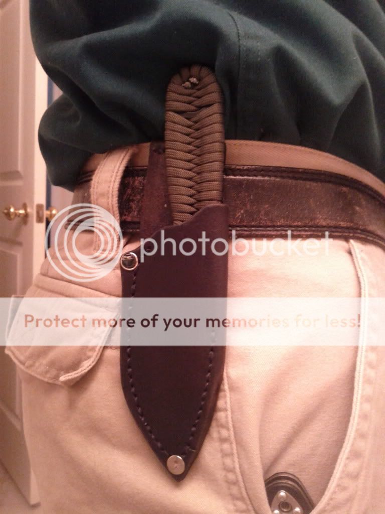

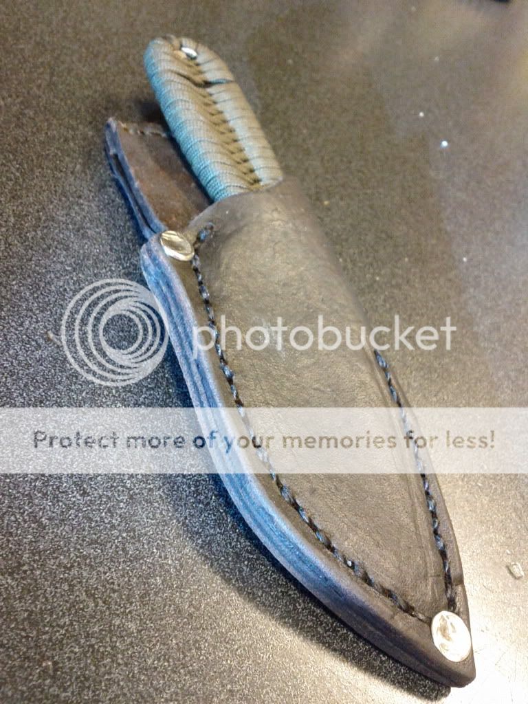

Here is a picture that may show detail a little better. I will start the next one tonight and pay more attention to detail.
The backside isnt so pretty. I will upload a picture soon. The rivets were a last minute decision and I had to cut a little bit of leather off of the belt look portion to fit the top rivet. Other than that its ok. Will post a picture soon.
It looks good. Only think I can tell ya, since you've got the idea down, is to keep at it. You'll get better and better with each one. You should have seen my first sheaths that I seriously tried to make. Regardless you'll get better the more you do it. Just keep at it!!
