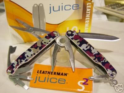

Have you seen any of the Australian S2 or Kf4 models with the camoflage finish? They look pretty cool.
~Bob
Camo? Nope, havent' seen that... damn, now I'll have to get one! ;)
Yeah, it was Costco. Lucky members.
I checked, and XE6's are going for around $40; if you feel the need for all the tools, you might as well pry an extra $10 and get the Pro. The look on your favorite wine snob's face, when you deftly de-foil and de-cork that nice 2002 Shiraz with your Leatherman like a professional sommelier, has gotta be worth a few bucks! :D
Both the S2 and the Kf4 were produced in a green camo and a brown camo, exclusively for the Australian market. Here is a picture of the brown camo S2:
~Bob
~Bob
Pretty, but how do you find it when you drop in along the trail? :rolleyes: :p
