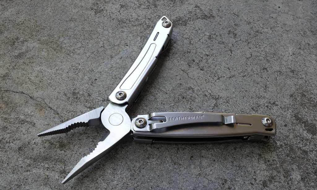

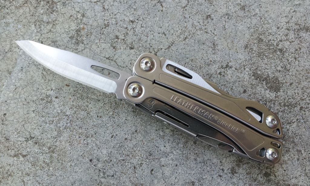

Hey peoples,
I've been using a Leatherman Sidekick for over two months now. I've enjoyed it quite a bit, and it has proven to me to be a good as it's larger cousins. I've had a Wave and Surge as well, though, the Sidekick has proven to be a good all-around package. I compared my Sidekick to my friend's Wave the the other day, and found several differences. While the Sidekick has fewer tools, it is smaller and lighter. It has a fine edge and a serrated edge knife, both of which take and hold a razor's edge. The plain edge, after convexing, cuts through materials with very little to no pressure. The pliers have proven to be both dextrous and strong. Using them I pulled several splinters (and cactus thorns) out of my hands, tightened some bolts around the house, and snipped many wires and vines (stinking wysteria). I see the occassional rust, though, only on the plain edge knife and it comes off easily. The saw works well and I used it several times on some hickory poles (it also makes nice notches). The back of the saw blade is very rough, and catches well on a ferro rod sending showers of sparks.
I'm actually so impressed with the multitool, that I decided not to replace my lost Wave or Surge. I see no need for the larger tools. Oh, btw, the knife blades, after convexing, have only needed a light stropping to pop hair and cut through materials with ease. The saw's edge has remained sharp through over thirty hickory poles. :-) I'm pleased with it. Oh, before I forget again, the plain edge also makes excellent and thin
shavings.
I own two sidekicks and a wingman. I love the design and finish but the blade seemes to be made of a softer steel and does not hold an edge as well as some of my other leatherman tools.
I agree with everything you say, Mr. B2d, and its good to see that you are using your Sidekick just as God and Tim Leatherman intended. The Sidekick is quite a value. While the wire "cutter" is more of a pincher, and though the file and serrated blade are tiny, the tool as a whole functions well at most tasks. I especially like the springloaded plier, which I would like to see as standard on every MT. The Wingman was not as impressive, but that was because my example had cheapy scissors that would not stay locked open. Thanks for your nice look at the Sidekick. Here is my look at it on another forum.
