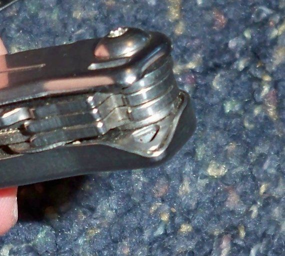

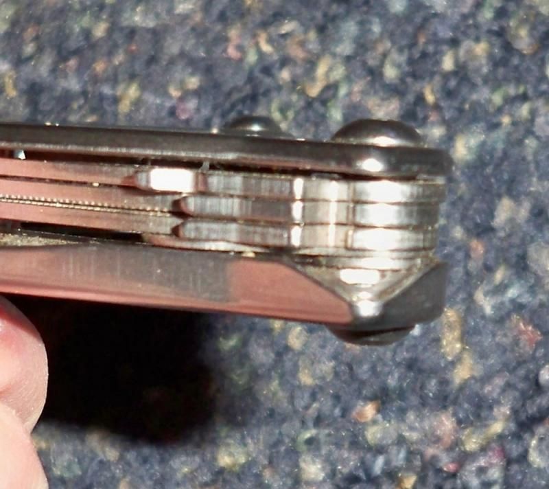

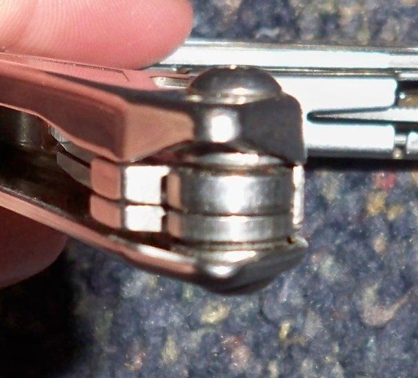

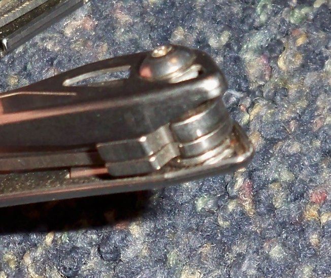

So while disassembling my Wingman I made the noob mistake of not keeping track of the washers. I thought I put them back in the right order/post but now there's a slight rattle. If anyone could tell me the right order or send me pictures of their Wingman that would be great. Thanks!
I don't have a Wingman, but I've got the Sidekick and it's more or less the same thing. Here are some pictures of the order mine's in. Hopefully they help.
