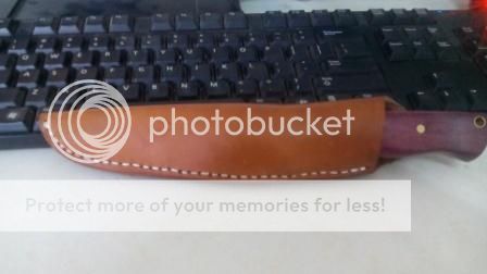

Left hand sheath
Mar 27, 2015
247
I made a left handed fold over pouch sheath by accident!!!!!!!
My template even had INSIDE and OUTSIDE written on it. Stupid me.
I'm still going to wear it though because it really doesn't matter I don't need to quick draw it and my sheaths stick in my pocket 90% of the time.
Well, if you are right handed and you use the sheath in a right hand pocket, you will find it is correct for that use. Pocket sheaths are just exactly backwards in normal use.
When laying out a pouch style sheath pattern for cutting, if it has an integral loop, the loop should always be on the right for a for a right hand sheath and left for a left hand sheath. If using a stitch on loop the knife edge should be on the left for a right hand sheath and visa versa for a left hand sheath.
As you noted, if you have notations on the template, then paying attention to that helps also.;)

It has an integral belt loop that is now wrong due to not paying attention. I seldom actually carry a fixed blade on my belt so its not a big deal.

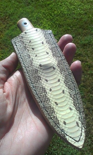

I've made many sheaths that go on either side. This one is for a Fiddleback Forge knife.

bflying, I call this style The Slotted sheath. Can go 360 on your belt, edge forward, spine forward, you choose. Just let your belt out a notch.
I have realized that is actually no problem to take a knife out of a left handed sheath twist your hand and its out
Beautiful sheat Dave. Is there any reason to not use something like that for folders?
Thanks Macan. Ya know don't know why it wouldn't, I've never tried it. This is my pancake sheath version 2.0 See how its just a pancake folded over?
Dave, your sheath reminds me of wine or fine art. The layman may not see the quality at first glance, but a critic would. Lovely work on that one.

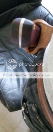

Yes the single loop sheath is exquisite here is my botched left hander.
I have to do a little reverse twist to draw the knife. No biggie.
Don't look like a botch to me, looks like an on purpose crsoodraw to me. Thanks Anthony.
