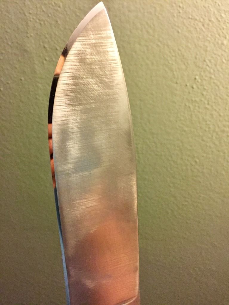

Gents n Ladies,
The Heavy Ordinance Grade Fusion Steal Heart (HOGFSH) is one of very few knives that I believe are near perfect. Mine is with Standard (Non-Magnum) Canvas Micarta handles slabs. For such a beast of a knife, it's very well balanced. Mine has been properly loved/used/abused and it was begging for me to make time to bring back its nasty fearsome bite. So ---- I did . . .

Thanks guys! I really appreciate the support ---- I just felt after everything that previous edge had been through, it deserved a proper sharpening and enhancing its teeth. Now it'll whittle hair and bite extra deep.
Same as usual I went with 19 degrees per side (38 degrees inclusive) and I polished/finished it at .5 microns on Balsa wood strops.
For those curious:
Diamond Grit Progression: 100, 200, 400, 600, 800, 1000
Ceramic Grit Progression: 1600, 1200, 1.4 micron, .6 micron
Balsa Wood Strops: 5 micron, 3.5 micron, 1 micron, and .5 micron
The reason why the Bevel widens, as was correctly stated Ratman79, is because the thickness of blade increases at those sections. You could try to keep the Bevel height consistent, but you would be forced to sacrifice cutting efficiency in the form of a more obtuse edge geometry. I personally have grown to enjoy the look. Now I know that my angle is consistent and that blade penetration will be noticeably improved where the Bevel has widened compared to if it wasn't.
As for a secondary --- I haven't really thought to dabble. At the moment, the results I'm getting are definitely meeting my needs ;)

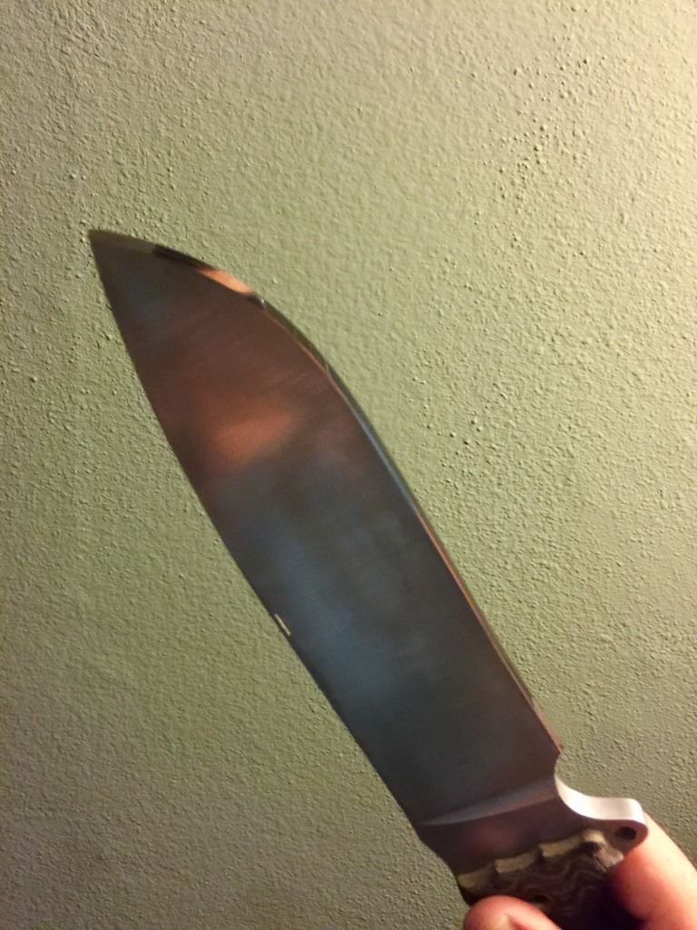

Great job as always! One of the pics makes it look like there is some minor chipping near the tip, is that just an optical illusion?
Good eye my friend . . . Indeed that section did have some edge chipping after I drove it directly into a big rock. I figured that portion of the edge could be realigned so as to still allow efficient cutting without requiring me to grind away too much steel. So I made sure the face of the Bevel was mirror polished and the teeth of the chipped area properly aligned. In about a year, after some more heavy thrashing and edge maintenance on the sharp maker --- I'll pop it back in the Wicked Edge and grind out the chip.
