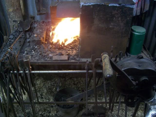

Well we are going ot use the coal forge with a hand cranked blower. Remember, no electricity
*Well heres the forge being brought up to temp, coking the green coal. We use a large deep fire to weld in and bank the coal up.

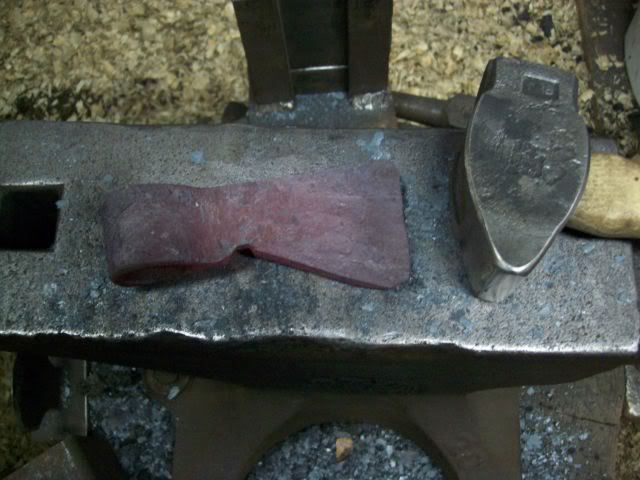

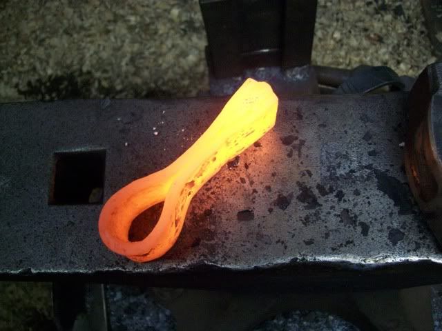

*Heres a pic of the axe head ready for its first welding pass. The eye roughly formed and the high carbon bit in place...
*After the very first welding pass, as you can see it still needs a couple more before starting any other magor work..

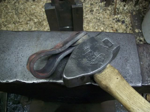

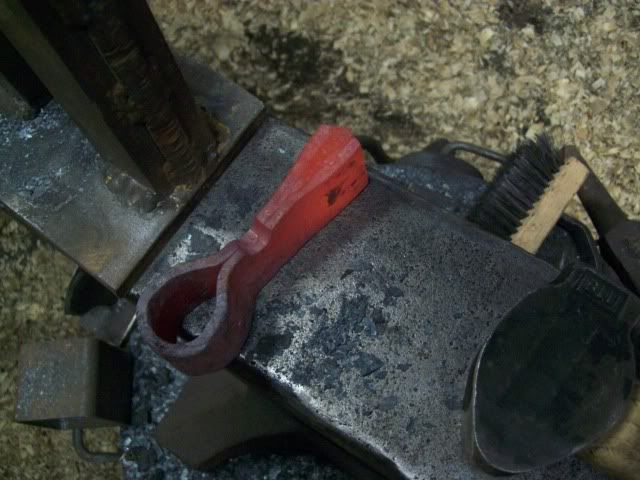

*Ok, at this point its been three welding heats and the drift as been used the first time to set the eye shape. It wll be used again in a step or two for the final shaping. You will see a pic of it there..
Here is where you see how good your weld is

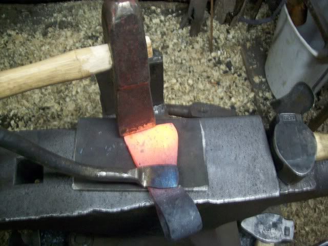

We use a fuller to forge a notch in the bottom of the blade. The edge of the anvil can be used as well. If your welds not right here you'll bust the head apart!
*Ok, now the head is ready for shaping. You know that funny looking thing on the back of your smithing hammer???? This is what its for, spreading the blade out wide
*Here we have spread the blade out and am getting ready to square it up to profile..

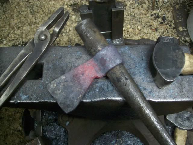

*Now we use the drift for final adjustments on the eye since about all the heavy forging is done. You can true it up again later if needed..
*Alright, since your using mild steel for the body its going to forge at a differnt rate than the high carbon. It will spread out over the high carbon completely jacketing it. The edge of the blade needs to be trimmed up. Again since we dont know what a 2" x 72" grinder is
we are using a handled hot cut to trim it up..
*Again no electricity so no grinder..We put it in the vise and hot rasp the head..

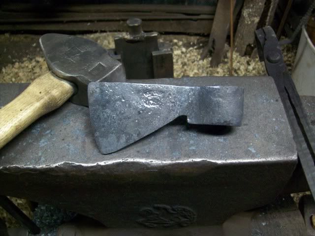

*Here we have a close final shape, stamped with a touch mark. Any filework on the spine and stoning will be done cold..This is what it would pretty much look like as a trade axe. We did go ahead and hot rasp the edge and set the bevels but you cant tell it here..Here we would have brought the edge up to temp and quenched it in the slack tub. Then final sharpening and out to some lucky frontiersman to use..
From what I have researched over the years I think this is a pretty close representation of how a traditional trade axe may have been made..Thanks
Please any questions or comments, fire away..
