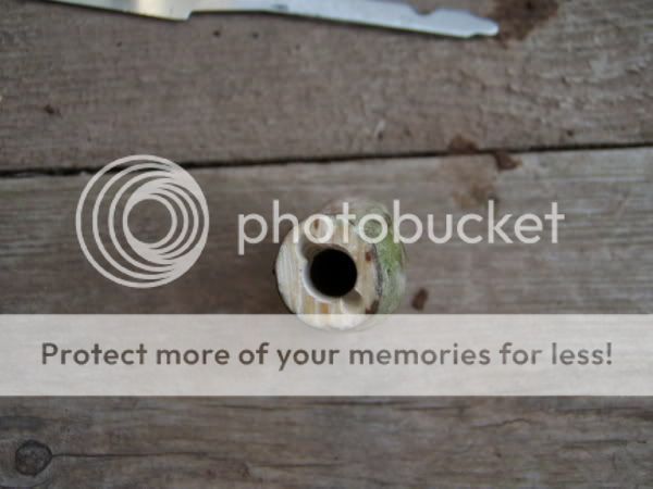

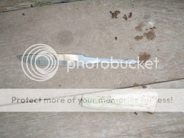

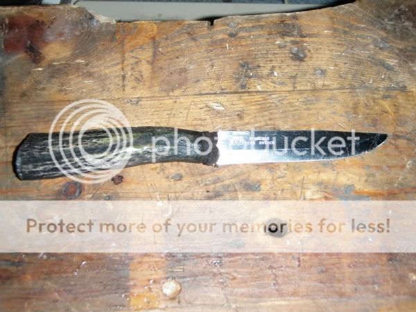

I had a Mora laying around for a while and I wasn't really thrilled with the plastic handle so I decided to change it.For antler.
I drilled out the center of the antler and made 2 cuts to accommodate the wider parts of the blades tang.
once I got it seated in the handle with the epoxy I wrapped the transition point with leather and colored the antler with Japanese ink.A little sanding and this is what I ended up with....

Wouldn't really call it a mod, it's more like completely new. Only thing saying Mora is the Logo, the rest is totally different.

WOW!! That is a great looking MORA you have there. What model did you start with? What's the specs on the blade?
Thanks for posting the pics.
Nala
Thanks for the kind words. I bought a bare blade, don't know the specs.
I think it is similar to the normal models. Handle fits the hand well, and I have Xl gloves. I gave the knife away as a present, so all I can do more is give you a link about how it's made;
