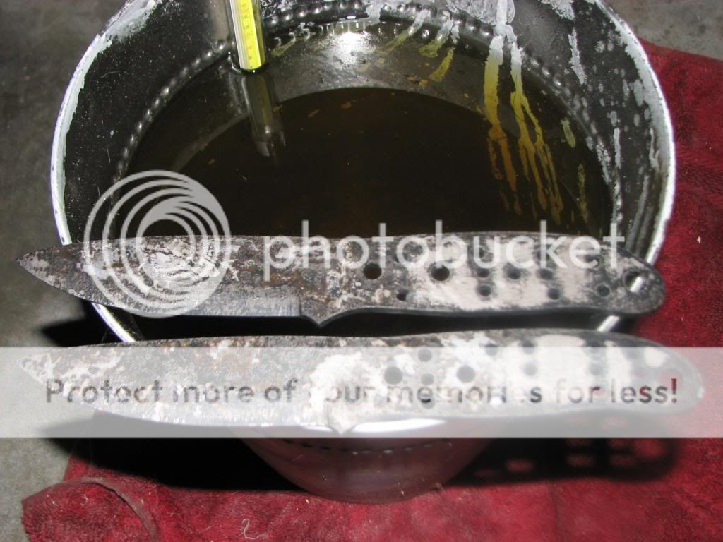

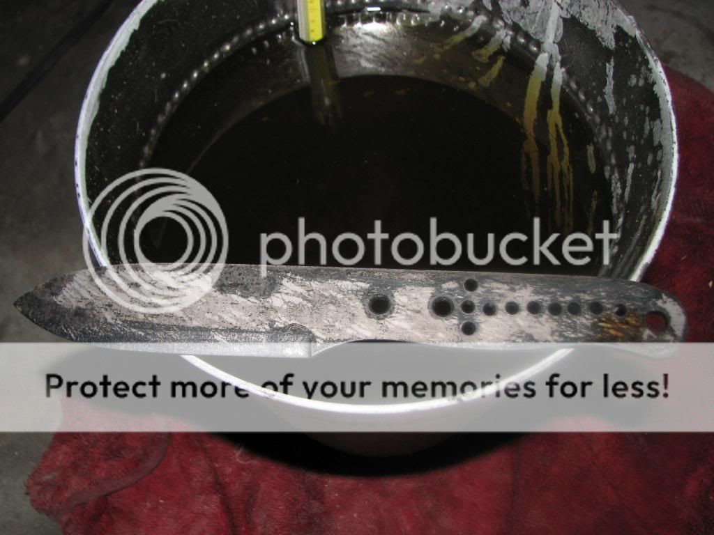

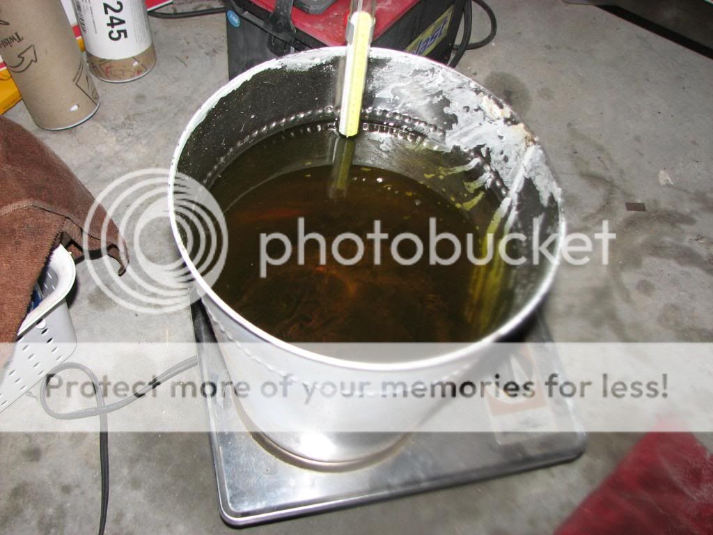

My quenchent pot sitting on the cooker..
Soak time..
knives cooling after quench

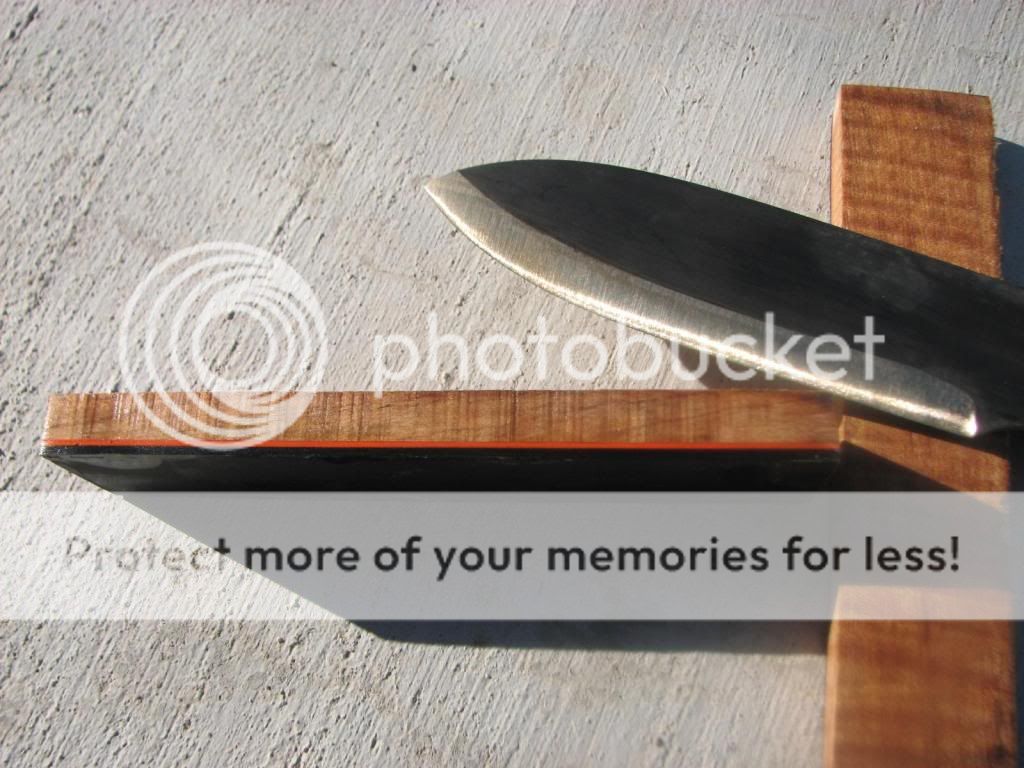

selected my wife's late step dad's quilted maple (30yrs kiln dried) for the scales for the first knife of '13 !!!

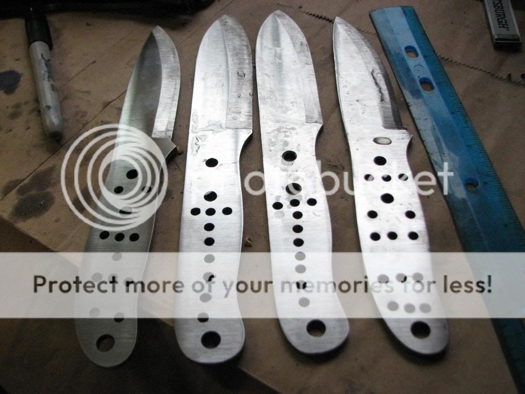

Scales drilled out and precut
I drill some recess holes to allow the epoxy a place to hide...
finished edge before gluing up scales

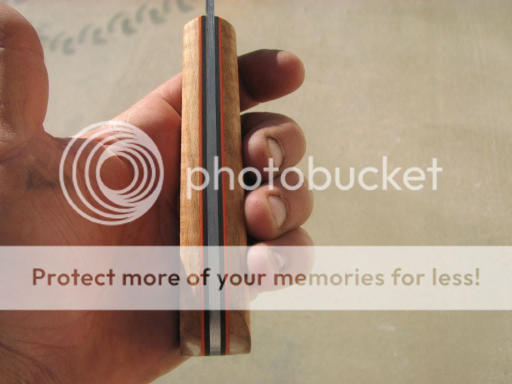

here you see the pins/tube installed, in my excitement I grabbed the wrong pins these were a little to short normally I have them sticking out of the handles a bit more, also I didn't realize I had placed the grain on one pin wrong (until I took the pic :) )
all glued up and ready to roll ..

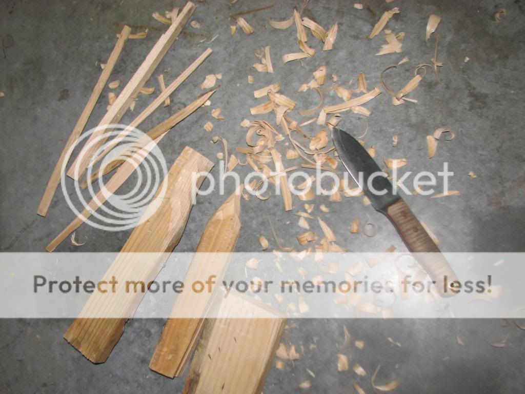

After not grinding for 6 months it takes a toll, I can't stand still for long periods of time without my knee killing me..(from the accident). I'm using this knife in a passaround I have going on so I'm not going to fluff it but leave it plain and simple.. Its going to be used up pretty good, I did a little whittling in the garage, battoned some 2x4 and it still had a really decent edge dulled it a little but was still able to shave and cut paper ok...
