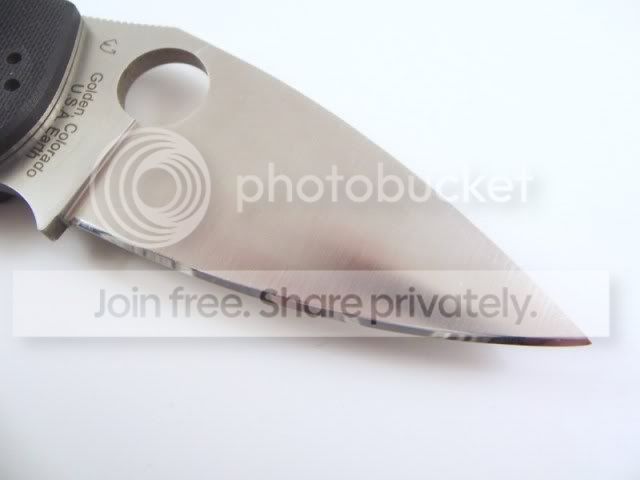

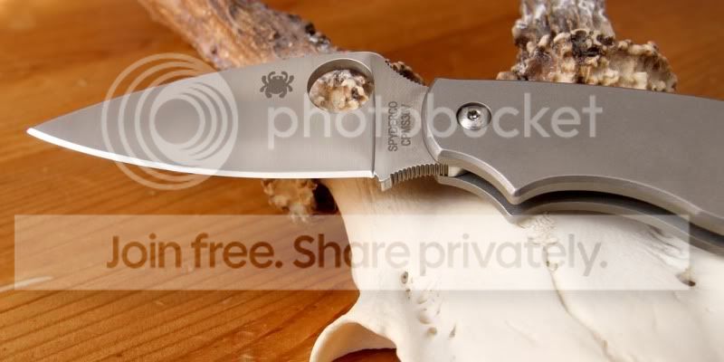

Nothing like a Spyderco with a nice Mirror Polish! :thumbup:
Delica 4
what are you using zippo? I'm still torn between edge pro and wicked edge. I'd get the WE, but I think the clamp might be funky for FFG blades.

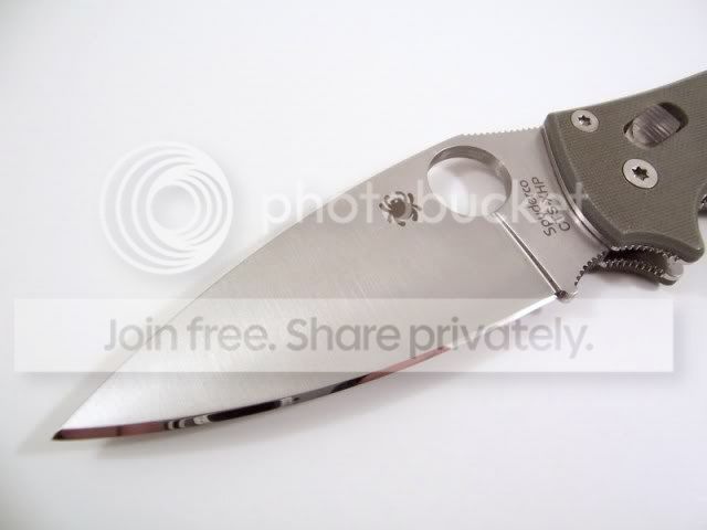

I have a few also, but I have shared the photos before...I hesitate to post them again...awww, what the heck?
I took these all the way to the spine;)

Gorgeous pics guys!
LOVE eyeing a Mirror Polish! :D
I used the Edge Pro Apex 4 to achieve the edge pictured.
Best rig to get if you don't like sharpening, but want the mirror polished edges.
As far as stropping I just use my natural leather strops. I would like to start using some sort of paste or spray, but have yet to indulge myself with the knowledge of what to use. The Edge Pro comes with 2 polishing tapes that are 1000 and 2000 grit, which is finer than many compounds for strops. Have to look into specifics if you want a tighter edge than what the EP already produces.

Easy. Buy a bottle of 1 Micron Hand American diamond spray. If you want to get OCD pick up 1/2 Micron at the same time and save on shipping. Put it on a nice hard piece of leather on wood backing. You will be amazed and its one of the best purchases I have made for sharpening.

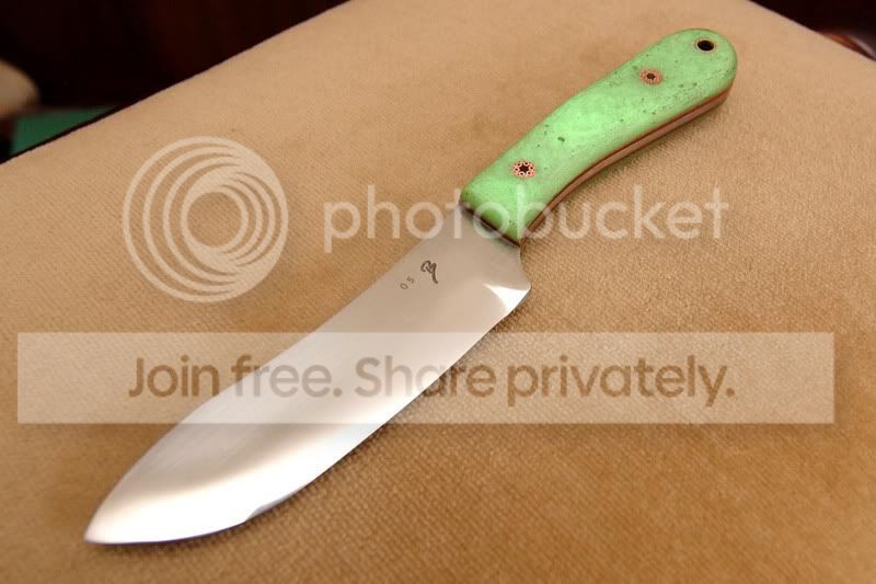

Some lovely edge-polishing in the pics so far; mine aren't as nice as those but here they are anyway!
Busse with nice edge- 'orrible sheath!
Nice edge- 'orrible attempt at GITD handle!
mule team S35VN
