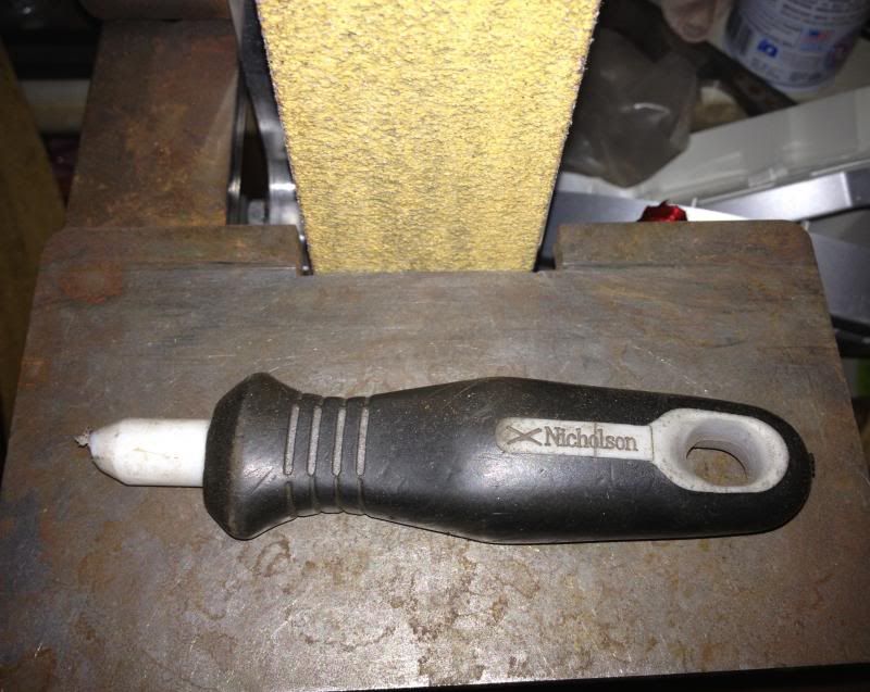

Here is mine...a piece of teflon shoved into a file handle. I've ground an angle into the tip, as that is more comfortable and easier for me to control than holding it straight on.
I use my fingers for final passes for a machine finish though, as it marks the blade. I assume anything like this will get steel/abrasive dust embedded that will cause scratches.
