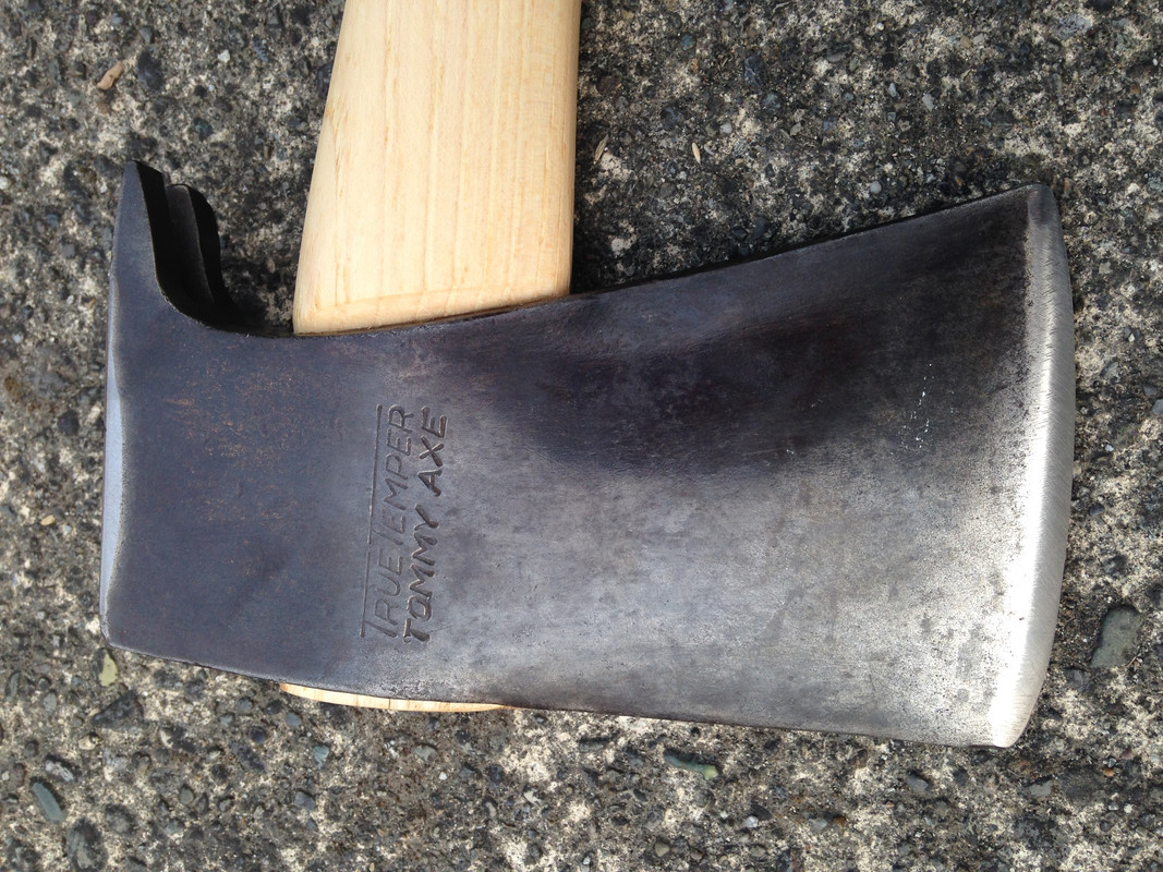

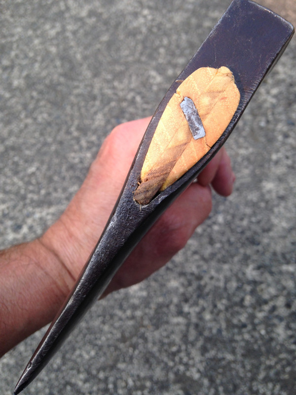

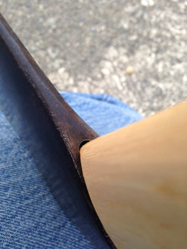

Here is mine. Thanks to all the folks on here for their Tommy Axe knowledge. The head was in decent shape. But the handle not so much. And not even the original. So after research I knew I wanted something 18" to 20". What I found is a V&B 19" California Framing Hammer handle. The handle haft was plenty wide but a bit short. So I had to move the shoulder down about 1/2" past the factory shoulder so I could get the wood to fill most of the eye. Then the wedge. I've never spent so much time on a wedge. But this one needed to be perfect.
Let's see your TT Tommy Axes !
