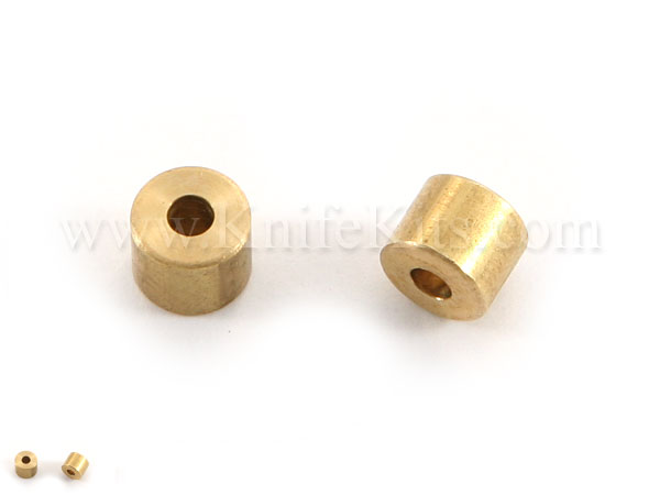

Hello,
Im getting confused over various types of bushings on the market. Can someone answer my questions below, as I think I may be over complicating things here.
Type 1: Bronze bushings:
Are these press fit into a blade? Do they roll around a pivot pin? The description on texasknife.com says that they roll around a pin as follows:
"This little guy fits between the main blade pin and the blade so that the bushing rolls on the pin instead of the blade rolling on the pin."
What, then, becomes the advantage of them since my understanding was that bushings help to eliminate pinching of the liners on the blade. If the bushing rotates, wouldnt any pressure on the bushing pinch the same way as without it? The only way I've ever heard of bushings being used was when they were made to be slightly wider than a blade, used with or without washers, so that when bolsters pere peened or pivot tighened, the liner crushed and locked the bushing in place while the blade was free to rotate without the majority of the friction of the liners pressing inward.

my use of such bushings has always been pressfit the major diameter of the bushing,(the blade) the inside diameter (pivot pin)is where the movement is going to happen I'm not generally a folder maker, but I've done some reblading on some, and I do design other things where pivot bushings are appropriate. the bushing usually rotates with the blade, the pin is stationary, the second ones I believe work similarly except the pin is a hollow sleeve with a setscrew either way I would personally make the bushing flush with the blade and leave half a thousandth to either the liner or washers, personally I don't like washers unless a recess is cut in the liners to recess them. they leave more room otherwise for crap to gum up your action, but then again, I'm not a folder expert, there's no action in ost of my knives to gum up.

I haven't read it in a while, but if I remember Tony Bose uses the bronze bushings in his slip joints. Best I can remember the blade rotates around the bushing that is locked into place by the liners.
Tony uses a bronze bushing and the blade rotates around it. He also leave it .001 thicker than the blade. This is so when he peens the pivot pin material he can never pinch the blade.
So all these comments seem to indicate that for slipjoints, the bushings are designed to remain stationary and be rotated around by the blade. This makes sense because peening wouldn't bind the blade. It doesnt make sense to have the bushing rotate around the pivot pin or else you're leaving the square-ness of the pivot hole to the manufacturer wheras with a stationary bushing, you can ream and ensure the blade is square to the bushing.

I think you'll find that each maker uses the same bushings in a little different way....just to solve issues, or bring out a desired characteristic.
Personally, I use both bronze and 416 bushings, along with bronze washers. I use them is such a way that the bushing is clamped between the liners, with the bushing being .0005 to .001 longer than the blade is thick. The blade rotates on the OD of the bushing. I personally do not like the bushing/pivot combos that are sold. I suppose that if an individual is making a number of identical folders they might be a good thing, but since I create mostly one of a kinds, I find them too limiting.
As for the pivots themselves, I personally use 1/8" OD "threaded barrels", with 2-56 internal threads. I match this with a bushing that has a .250 OD X .125 ID. As you mentioned, they work exactly like peening a pin, with the exception that the folder can be disassembled without destroying any part of it.

When i used bushings,i used the same method! you want your liners to pinch the bushing,not the blade.this eliminates pinching blade between handles,and makes the knife operate very smooth.the trick is getting the bushing with in
.005 of blade thickness,square on both sides :)
