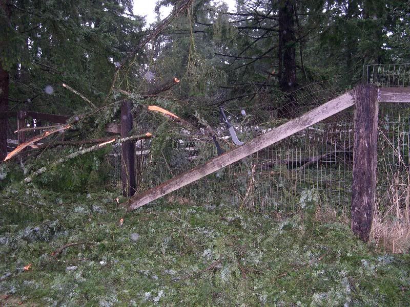

Here's a pic of one of two fence sections that had the 2x6 top rail knocked down and the 12-ga horse wire crumpled down. BTW, all those fir branches on the ground are *not* supposed to be there. They are on the clean-up list. About halfway down that slanted 2x6 you can spot the BM-E and the billhook.

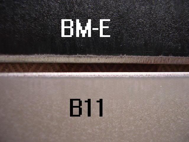

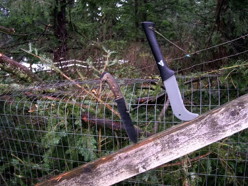

Here's a close up of the steelware.

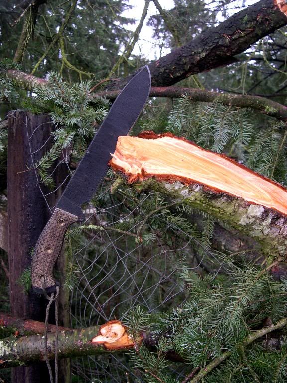

1 ea BM-E hangin' out.

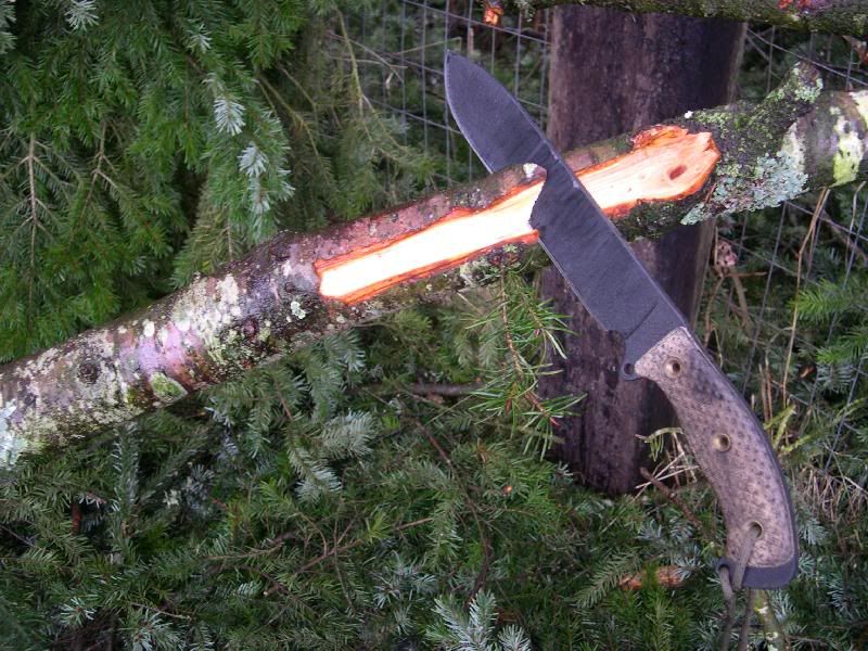

Penetration!! That was the first swing into that branch and it sank satisfyingly deep. Gotta hand it to the Battle Mistresses -- they are beasts when it comes to chopping.

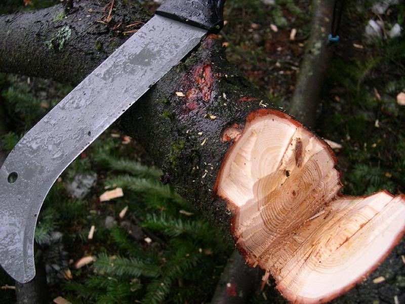

The billhook and a decent size branch it chopped through with ease. Note how deep one of the first chops sank into the sapwood near the top of the cut, where the flat large chip facet shows.
