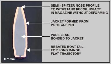

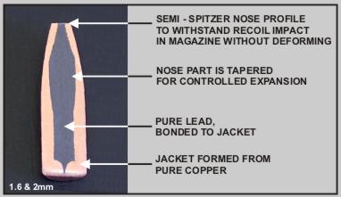

There seems to be confusion as to the term "boat tail" here.
A "boat tail" is a taper at the base of the bullet.
A "spitzer" is a pointed tip at the front of the bullet.
Spitzer
Boat Tail
Perhaps some of the confusion is because a boat tail wouldn't be as much benefit without a spitzer tip.
