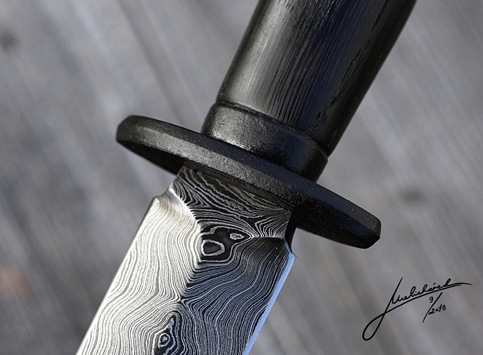

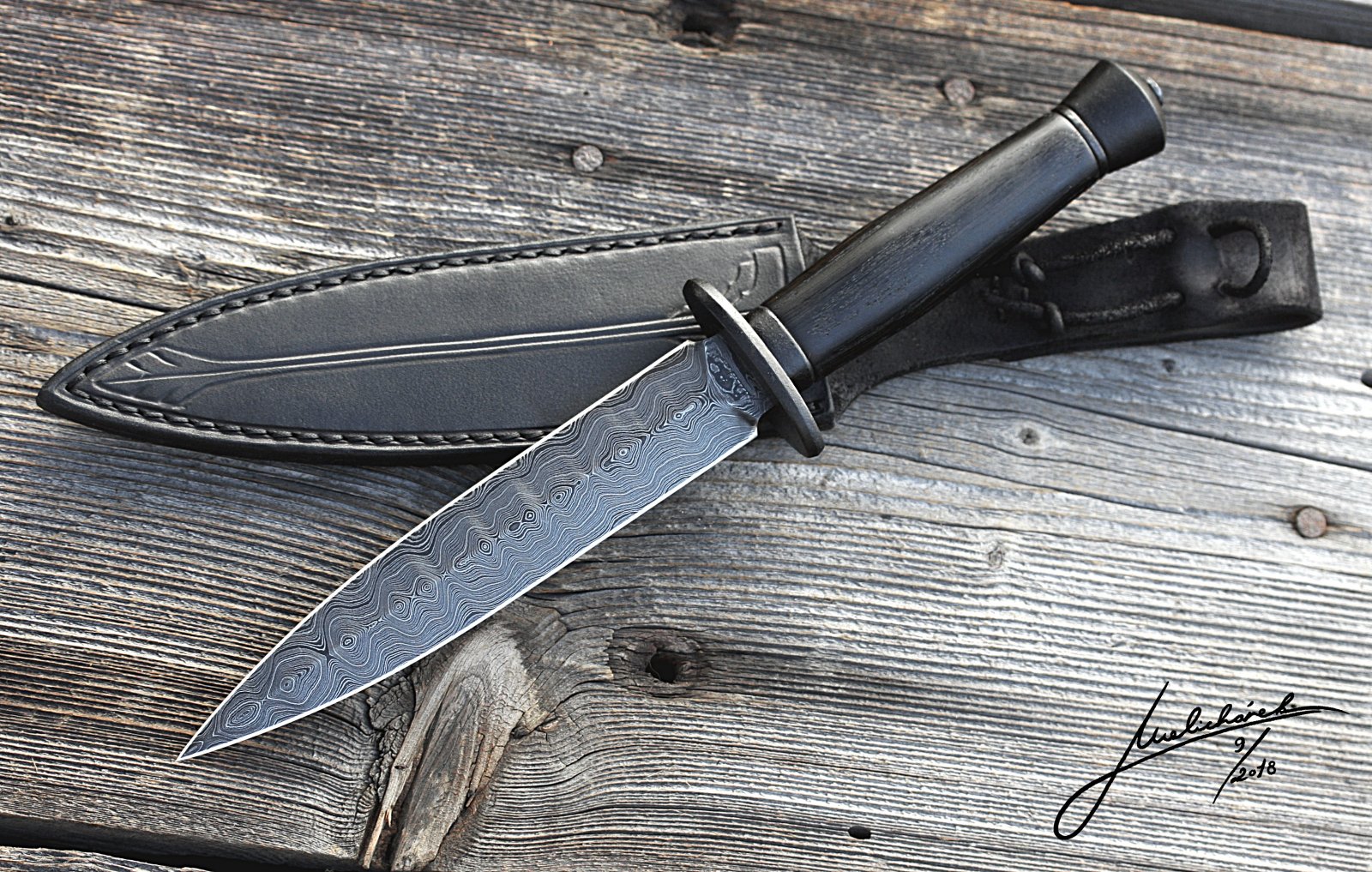

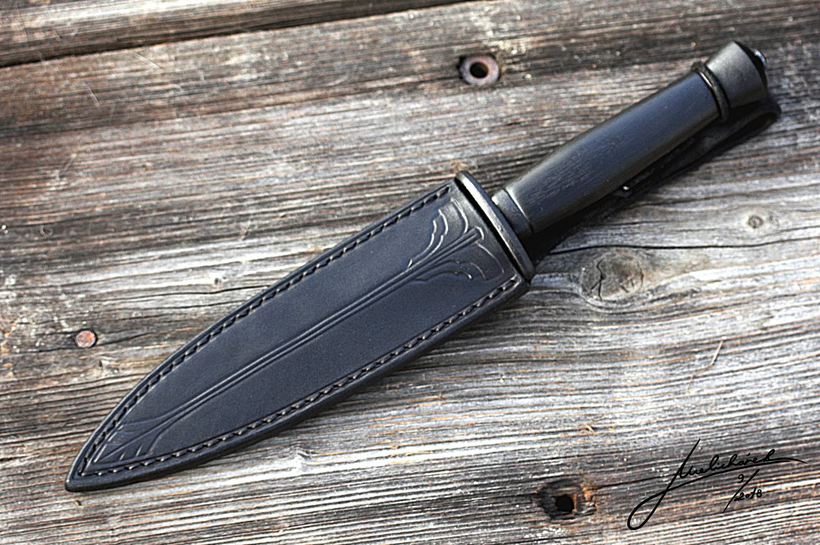

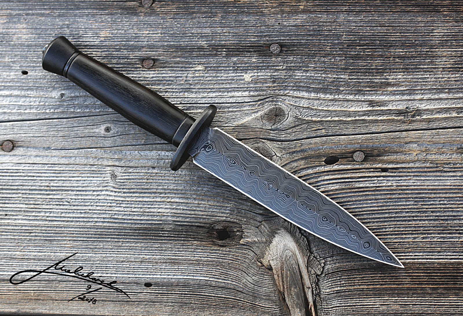

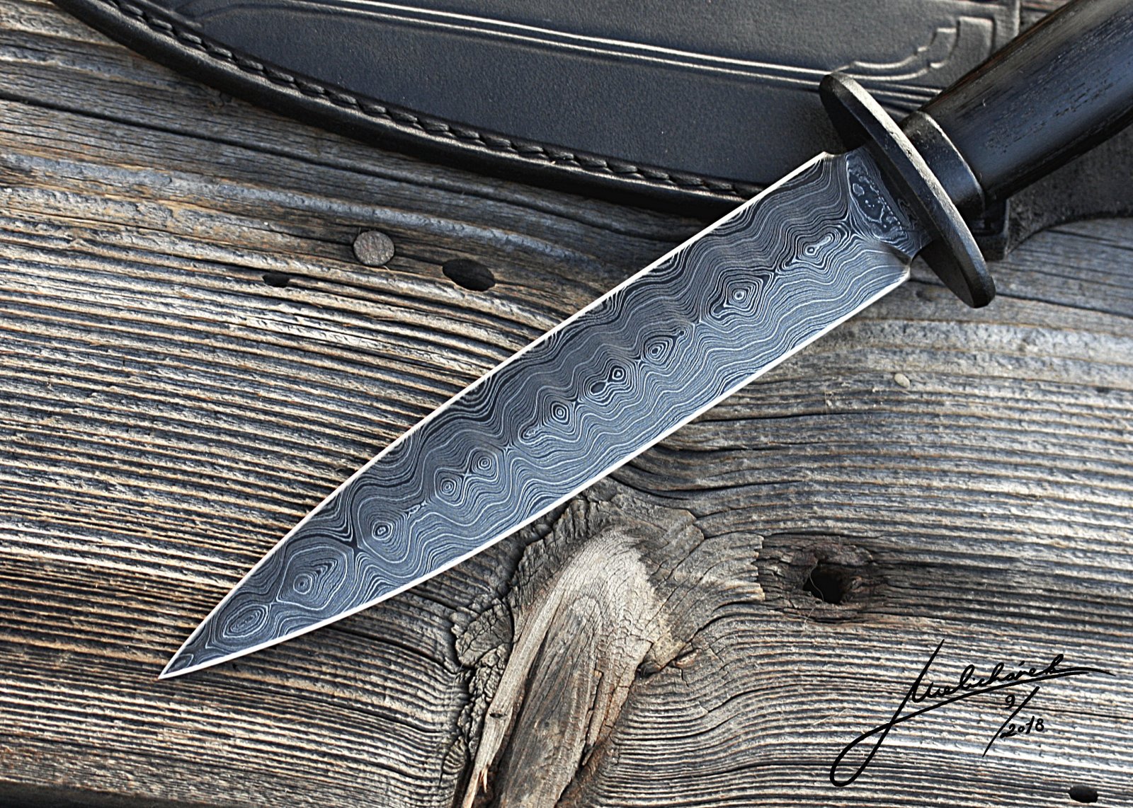

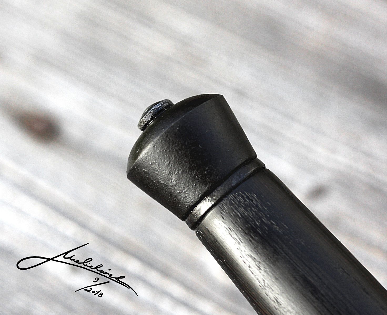

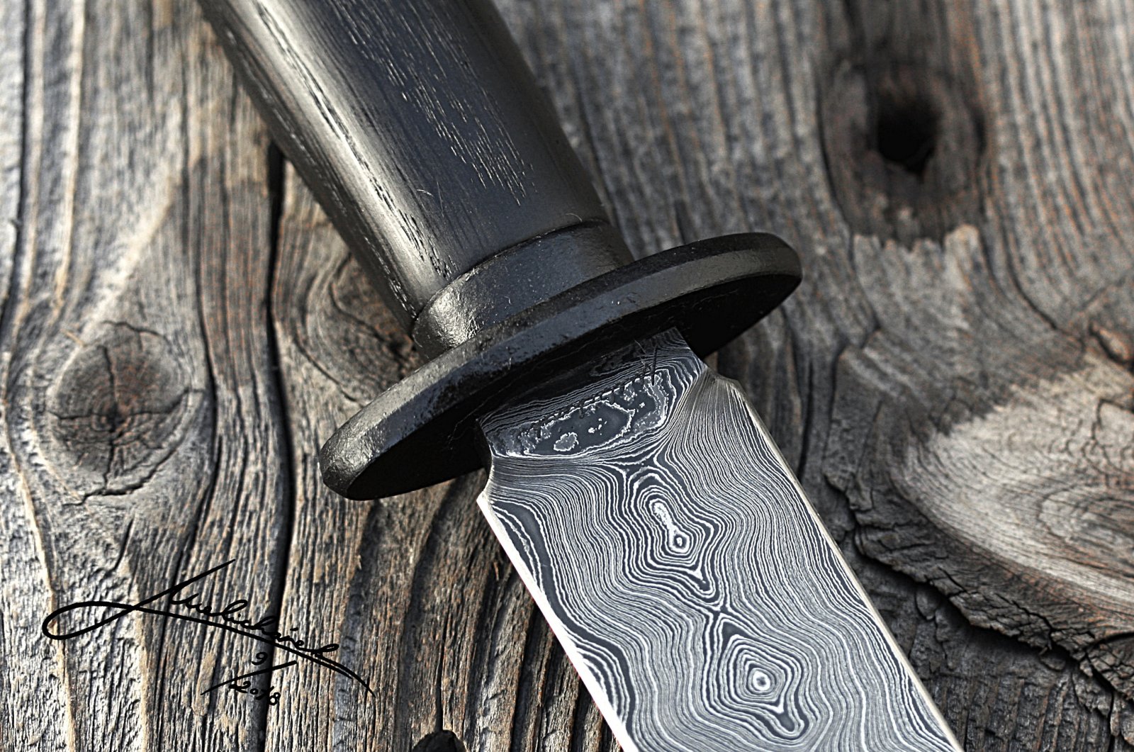

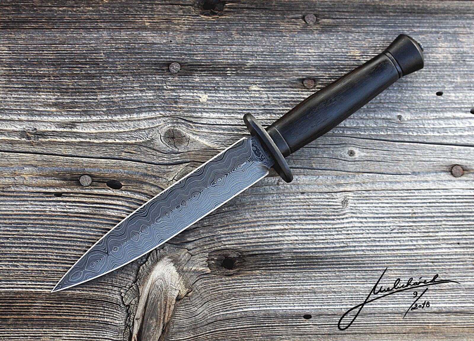

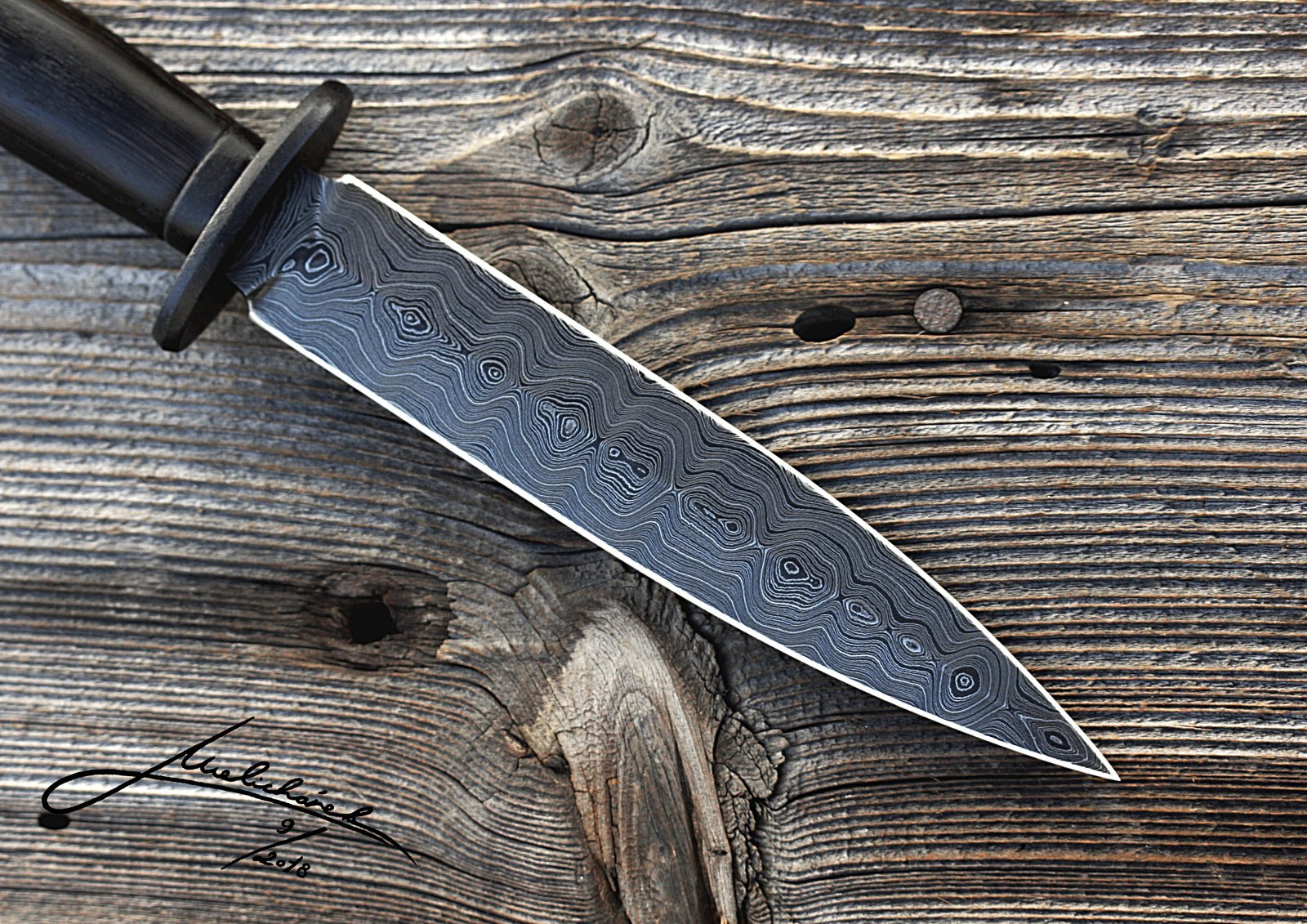

This time I made something bit different than I usually do. Its a dagger slightly inspired by F-S fighting knife. It is a gift from son to his father - a WW2 veteran
Thanks for watching and "see" you with more knives soon ..
bb Petr
LEXO

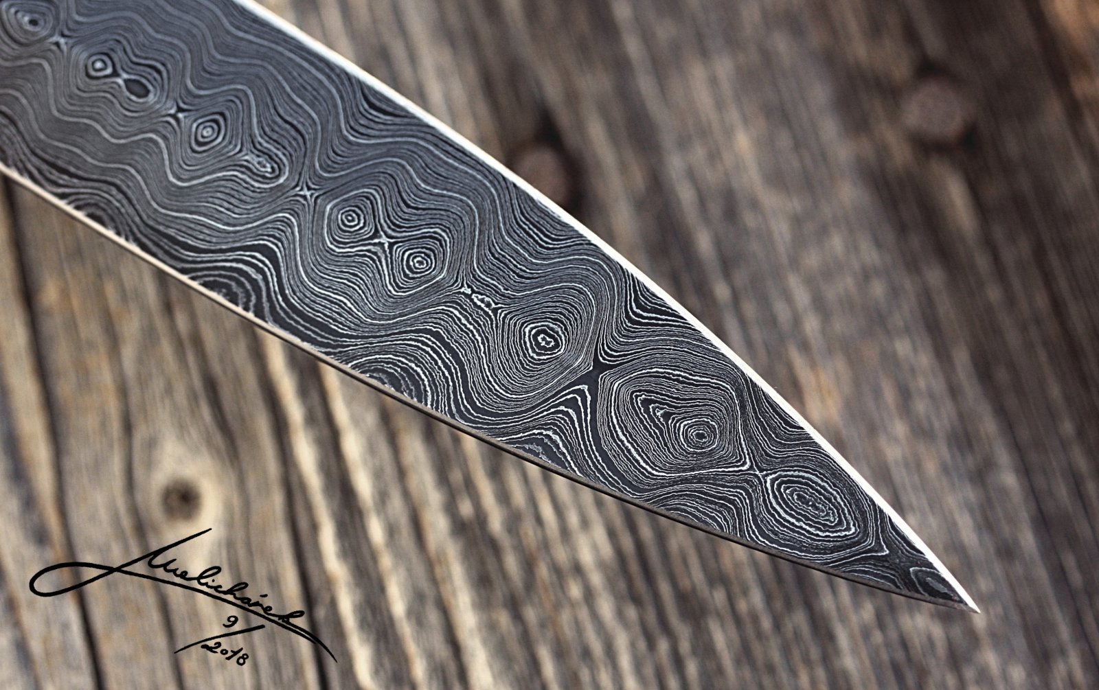

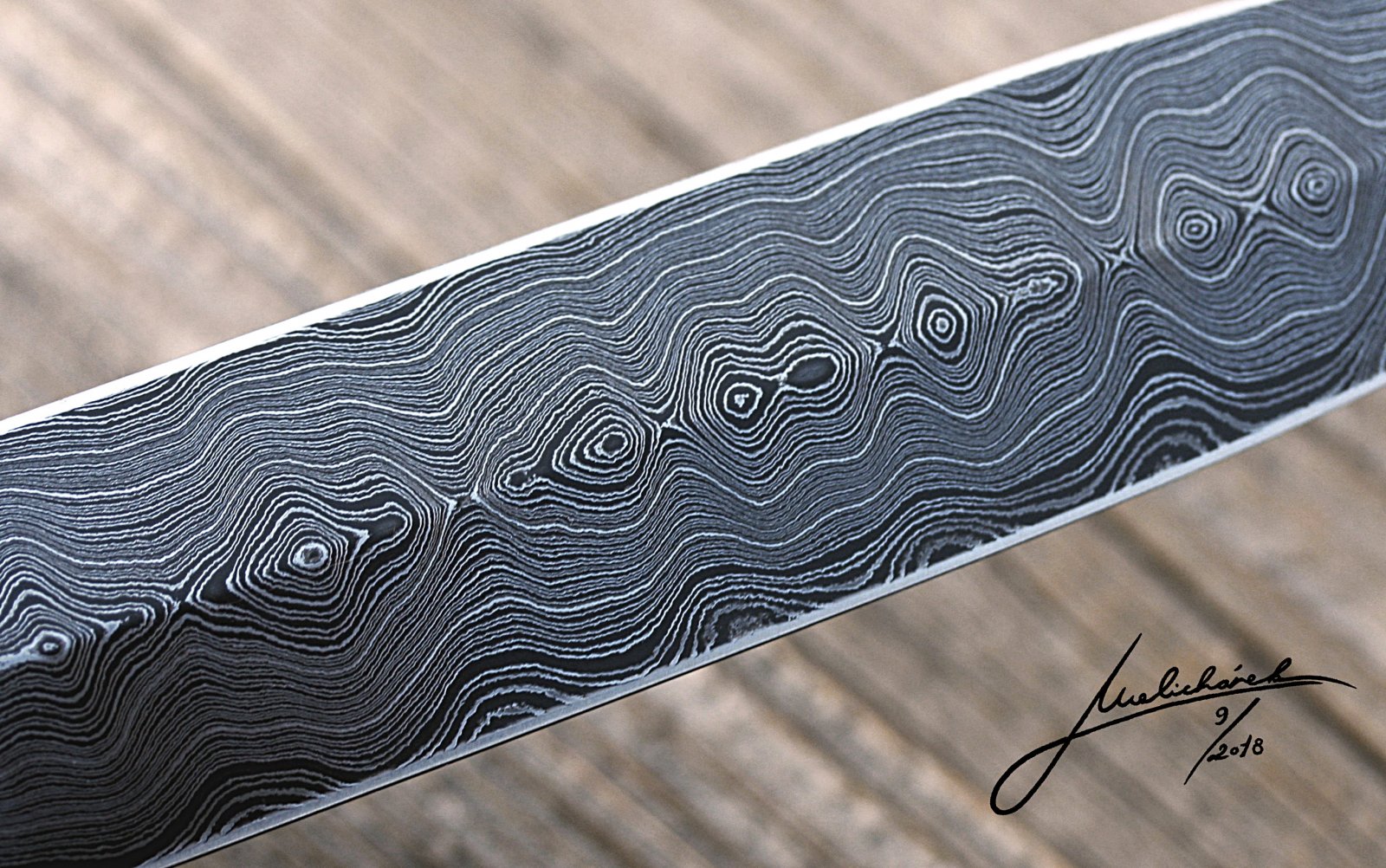

Blade - Damascus steel 1,2842 (O2) + 75ni8 Uddeholm (15N20)

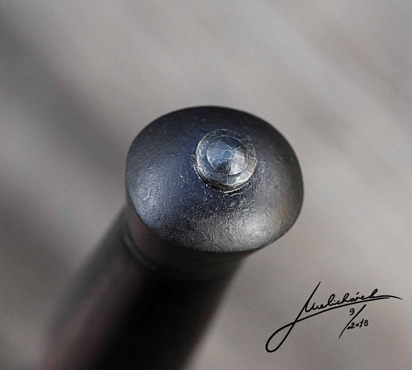

Guard/pommel - patinated mild steel
Handle - Ancient bog oak
Average length - 30,5 cm (approx- 12 inches) , blade - 17,5 cm (approx- 6,9 inches).
Blade width at widest point 30 mm (approx 1,18 inches )mm , blade thickness max 6 mm (0,236 inches) - distal taper
