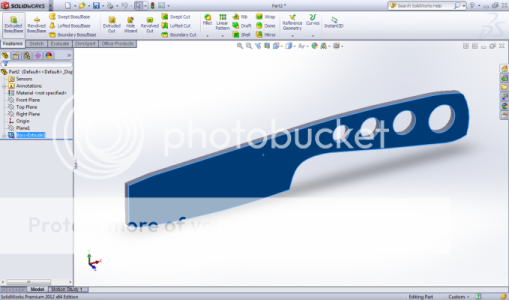

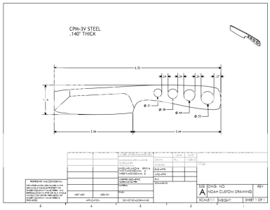

Since I am an engineering student and Tim is a machinist, 3D-models and drawings were bread and butter in the beginning of this project.
After a few back-and-forth emails, we decided to use CPM-3V. Tim then went to work and kept me update with each step.

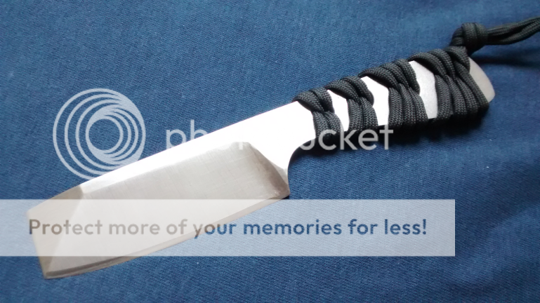

At this stage, I was really curious to see if I can finish the knife myself. So, I paid Tim for the work already done and had him send the workpiece to me. From this point, there were only a few steps left: rounding/polishing, heat treating, and creating the edge. Just this past week, I finally got around to working on it and sending it to Peters' Heat Treating - great company, by the way. The knife comes back at HRC 60 with a nice, thin, maroon layer of oxidation that is quickly removed with Scotchbrite, WD-40, and elbow grease.
Now is time for the fun part: taking the 0.020" edge down to shaving sharp. Manually. With an aluminum oxide stone.
Two hours and a clogged stone later, I have my first custom-collaboration.
Now I'm sitting here with bald patches on my forearm, paper shreds in my trash can, and a proud smile on my face :D

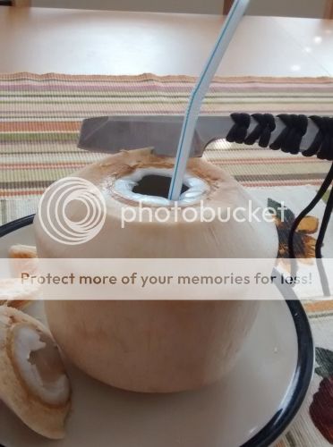

Over the past few weeks, I have used this for many food items with great success. It easily cuts apples, cleanly cuts steak, bites into onion and tomato skins, and - most importantly - effortlessly opens up coconuts.
I find myself using it to pry things without fear of breaking or dulling because the forward chisel edge is thick and purposely kept NOT razor sharp. Haven't hammered it as a chisel yet, but I'm looking forward to the opportunity.
