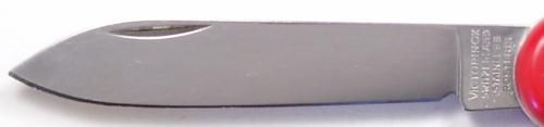

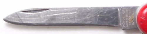

Aggressive and frequent sharpening, along with improper technique will get you from this...
...to this...
....in very short order.
