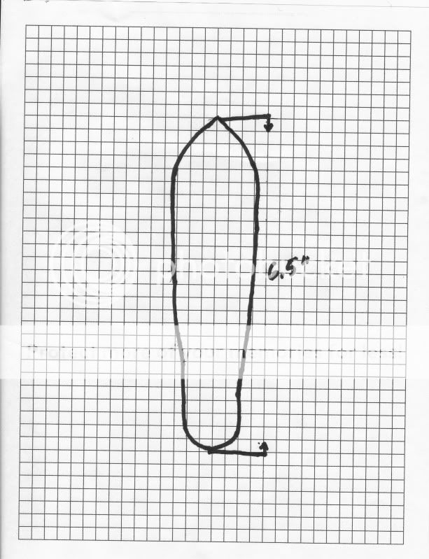

1.5" electrical PVC conduit, cut a shape roughly like this (I used a cutoff wheel on a dremel- hacksaw blade would probably work too, finished the edges w/ a sanding drum- sandpaper would work too):
end up w/ something like this, weighs in at 0/75 oz:

the Coghlan's isn't a bad trowel- the DIY one is about half the weight though - I can't remember what the cost of the section of pvc conduit was, but it was cheap (sold by the foot- you could make several out of a one foot section)
it's possible the Coghlan's is more durable (haven't used one), but this is pretty thick pvc and appears to be thus far pretty durable
