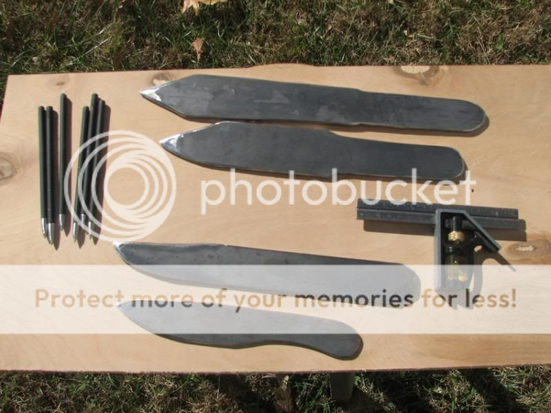

tried my hand at making a couple blades to throw while I'm learning so I wouldn't risk the good ones.
There should be a warning about this!! :eek: All I wanted was a few inexpensive blades to throw, now I have a whole nother hobby!!!!! :(
crap :grumpy:
For a first attempt, I am rather pleased even though they are very rough and crude. But I'm on the search for good steel and am reading all I can get my hands on to learn the annealing/heat treating process for throwing knives.
Should keep me busy and out of trouble. (yeah, right)
I like em!
I also like that they look rough enough finished handles that you have control without handle wrapping. Some I've bought are so slick I just can't seem to really nuance (is that the right word) them at longer ranges without keeping them wrapped.
I'm not sure I would know the difference, slick or rough. ;)
I'm watching Pat Minters videos and doing all I can to emulate his throwing style. It seems sooooo effortless. I seem to like the bigger blades a lot more than the others, so that is where I'm heading I think. Once I get the designs and the process down better, I'm gonna cut loose and see if I can make a really nice set of throwers. Should be interesting.

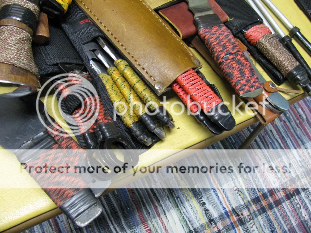

I just mean that when I started I was trying to use plain bought metal knives and they seemed slippery to me, some more than others, particularly after cleaning or oiling. The painted finish on Condor knives was the slickest to me. So I started wrapping the handles. This greatly improved my control and release of them but now the unwrapped ones feel so odd in my hand that I am constantly renewing wraps. This led to me using lots of different targets because I could not damage my own handles if the knives never struck one another. This has preserved the blades as well. The handles on yours look like they have some roughness to them and may be tactile enough to give you good control.

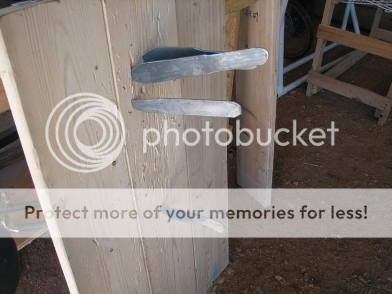

Here is a pic of the duracoat with soft sand texture. Feels like a plasticky (yeah I know not a word) sand paper. Just enough to grip, but still slides and releases easy. If I stay with this type finish, I'll switch to an off the shelf (more affordable) one.

Thanks BK and WW. If you choose DIY textured paint, I'd suggest Rustoleum Textured. I've use that in the past on painball guns, misc gear and outdoor patio furniture. When applied over a self etching primer, it's almost as good as this duracoat I used.. At least as far as knife handling and finish top coating. It all wears off in contact places eventually ..

But to your question. This was a duracoat semi gloss black (shake and bake kit?) along with some left over duracoat "Soft Sand Texture" additive I mixed with the paint in the air sprayer. It was all left over from a pistol refinish job I did just about a year ago, so I just thought I'd use it up before the temps dropped. Did it 2 weeks ago and just in time. went from the 50's to the 18 degrees now.
I didn't have the exact ratio for proper mix, but close enough to use it up on the 5 knives. I also baked them on the second day of drying at 120 degrees (my own best guess based on past use) for 2 hours, and after they cooled they were nice and hard, and the suspended sand particles felt more like hard polymer than rubbery. So just enough extra traction in gripping, but smooth enough for no effort on release.

Lastly here is an example of the wear after 2 weeks and hundreds of throws after the coating. Yes into my hardwood log round, and yes hitting other knives now and again. Nothing seems to last on the tips, but I like the look! :)
This is just throwing about an hour ago. Temp outside was 19 degrees, light snow on ground, grass and dirt slightly wiped off but wet.
And a minute later, wiped off and ready to be put back in storage pouch. Note the abrasions and wear. Not too bad!
