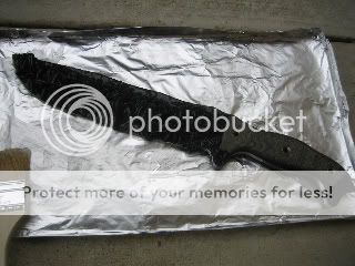

My apologies for adding another "I stripped my Busse" post but I'm stoked at how easy this was and wanted to share pics.
I had visions of doing a two tone blade where i'd keep the upper flat portion of the blade in raw form - INFI dimples and all -- and then polish up the lower portion.
Out came the Jasco stripper. Here is the before shot -- a perfectly good looking FBM.
After i layered on the stripper - it just sat quietly for a minute and then SSSSS -- the coating came to life and literally crawled off the blade.
And here it is in the raw -- I really like this look. It almost looked like a DC finish although not as bright.
But - not content to leave it alone, i polished up the lower portion. Man - I like how it turned out (for now):thumbup:

What kind of implements and methods did you use the polish thy FBM?
thumbs up on the two tone. I really like infidimples also. I think dimples are cute on women, why not on knifes.
Looks great
How did you polish it? By hand, or machine?
All by hand. I'm typing with one finger right now - i'm so sore :D
The spine was the hardest (did that a few weeks ago). There were grind marks that took a while to knock out.
For the flats, i used painters tape to protect the upper blade as much as possible and then went to town -- 100/220/400/600. I worked it spine to edge. I just kept at it until i was ready to go nuts.;)

You can do a lot by hand, just start off with 120 grit wet/dry paper and work your way up. I have all the power tools, but I still do a lot by hand. Power is easier, but it is also easier to screw up and remove too much, believe me, I know!!! LOL!!
