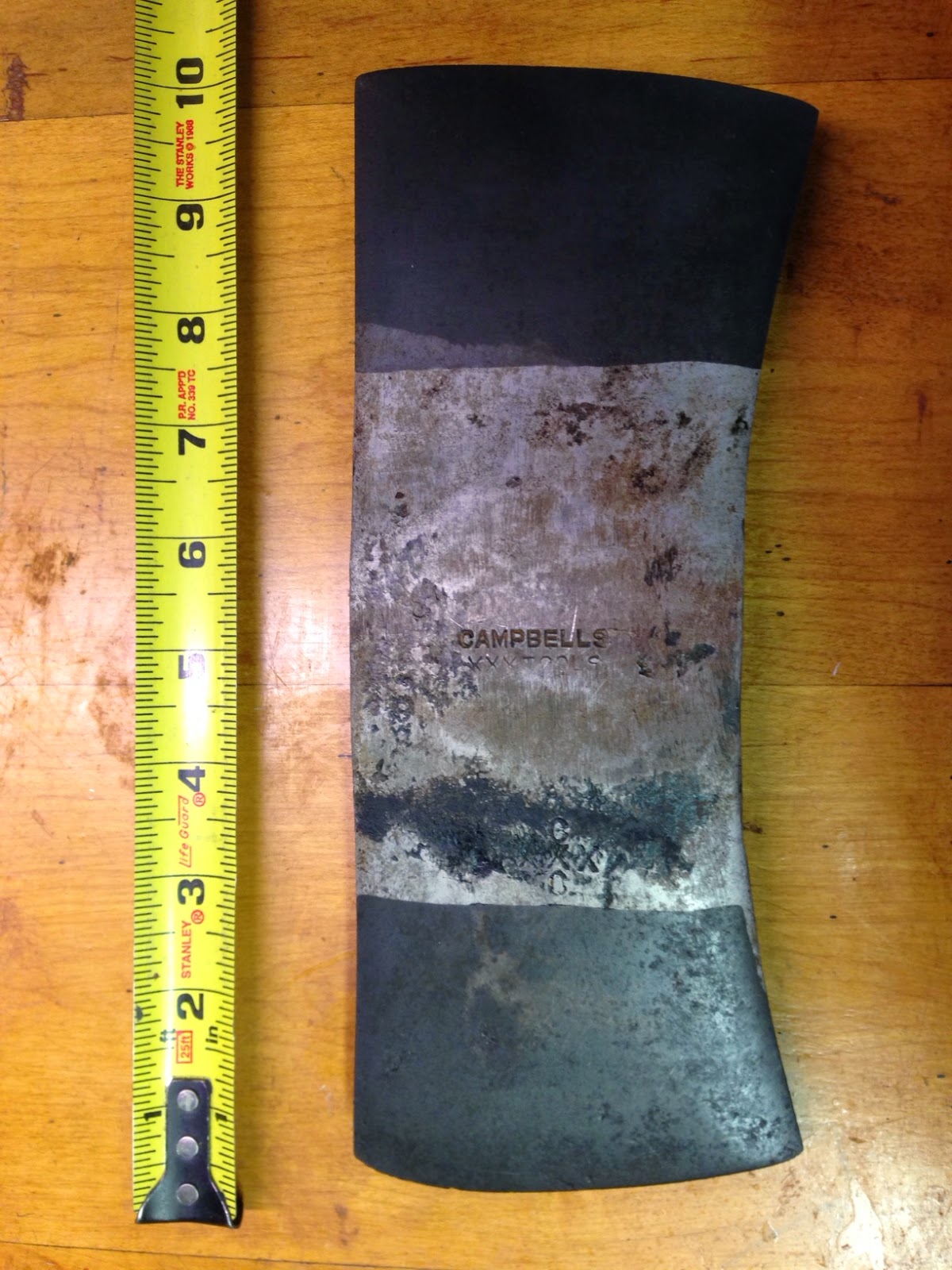

Do you think a swamping axe is profiled similarly between types of wood? Or would the hardwood have a shorter convex (and perhaps thicker) profile at the edge? I don't really have a lot of axes, I just recently decided to get locally made axes to compare to Gransfors. This is one that I recently found and just started using this past week.
I'm really liking it so far. I think I prefer the narrow bit (although I should soon have a Spiller and E&S to compare it to). I am definitely not a fan of the GB double-bit for limbing work, the width of the bit - especially above the centreline - seems to be a hindrance for close work.
This axe is 3.8 lbs. Surprisingly heavy for its size. It is fairly thin but I don't think I want to use it for swamping since I likely won't find any more 1926 axes with the factory edge.
Something along the lines of this would work, but with much greater curve along the edge protecting the heel and toe?

That Campbells is a very nice axe! I think an axe in that pattern but 2 1/2 to three pounds would be perfect for limbing for me.
