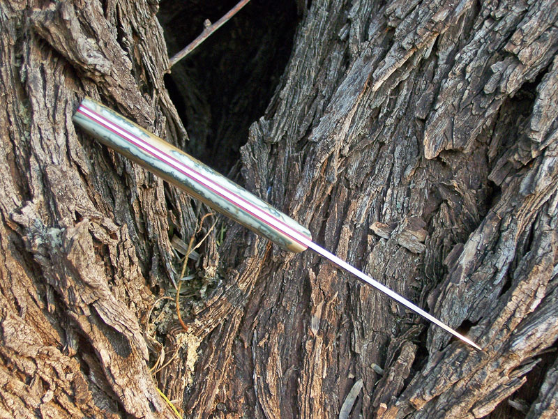

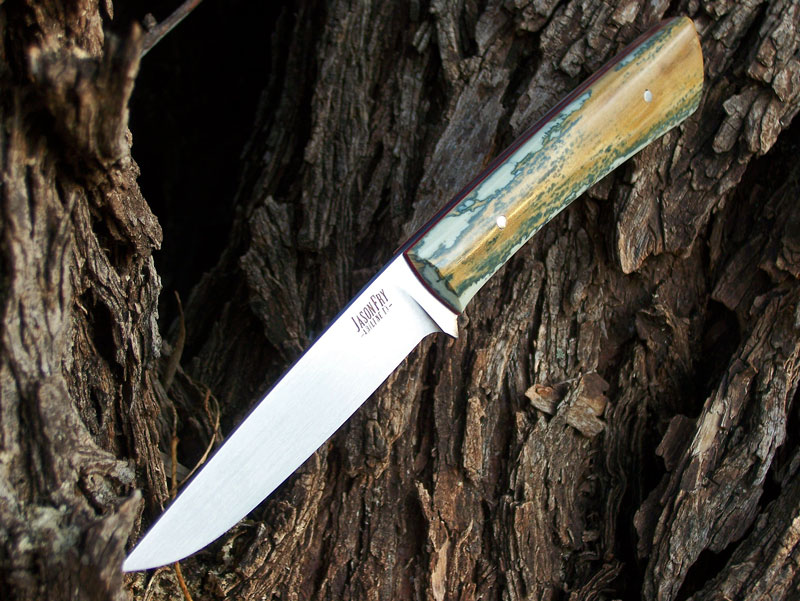

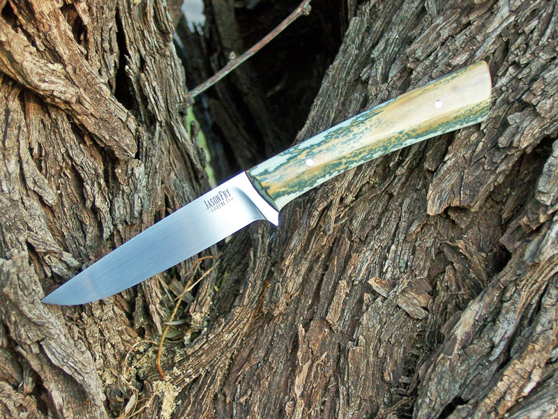

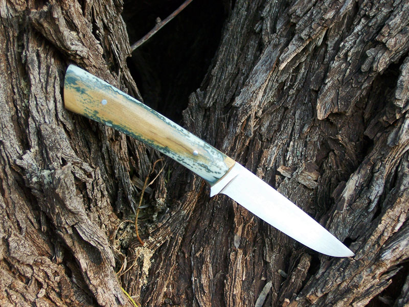

When I finally got around to a batch of carbon steel blades, I put the blank in. Because it started so thin, I did the heat treat first, then ground the tapered tang and bevels. I had picked up a nice thin set of mammoth from Charles Turnage at the Lone Star knife show, and the fit was perfect. Here's the final product, that will be on my table at the Knifemaker's Guild show in KY in September.
OAL is 7 inches, blade is 3 1/4.
