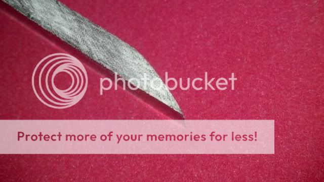

After cutting down a large chunk of micarta to make a handle, I had a little sliver of the stuff left too small to make a handle. I started just playing around with it on my belt sander, creating neat patterns in the layering, and ground down one side of it so I could count the layers in it. But then I realized I had made a micarta chisel, and that got me curious about how well that would work. Micarta is remarkably tough, after all.

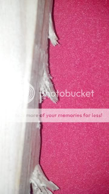

First I tried to make a featherstick using a nice dry piece of 2x6 I had laying there.
It works, but only marginally better than a butter knife would. And the edge started to bend and break, so it wouldn't work much after that.
So what about batoning? I resharpened it, and grabbed a hammer.
So far, so good.

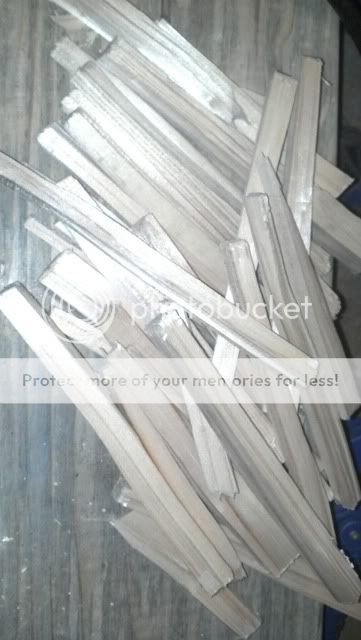

And then I got carried away...
That was a 6 inch piece of 2x6.

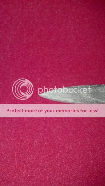

Then I decided to try a new shape.
Yep, that works too.
