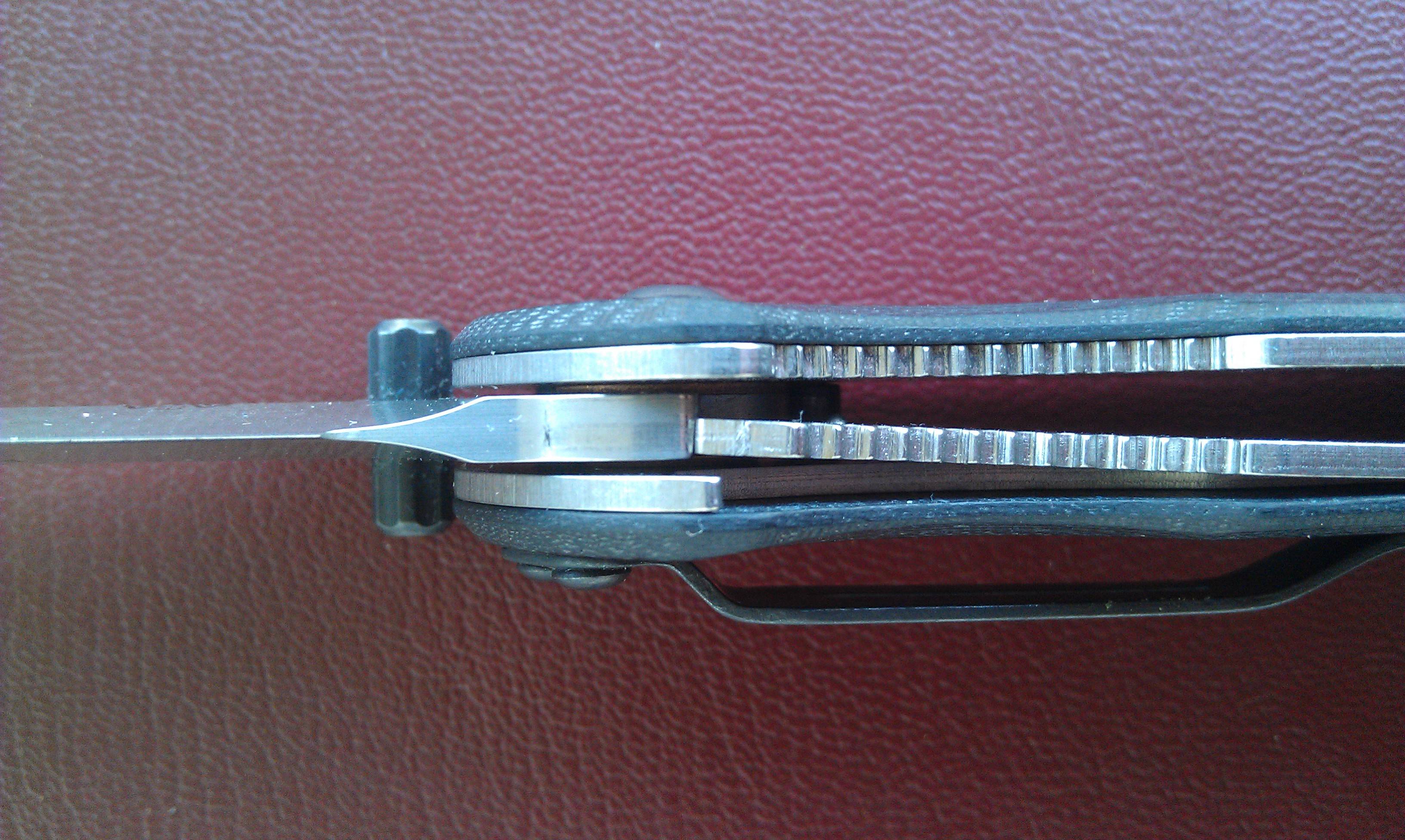

A photo of the lockup would really help.

1. The lockface isn't contacting the tang when the spine hits the stop pin- you need to pull it apart and bend the lockbar over farther. Go slow, just a little bit should do it.
2. The lockface is contacting the tang, but is slipping. Clean off both surfaces with some solvent and do the bending trick- will put more spring into it.
If when you bend the lockbar over, it gets very far to towards the opposite scale and might fall off the other side of the tang: you need to either get a larger stop pin or peen the lockface to bring the lockup back towards the middle of the tang. That's about the time to send it in if you still have a warranty.

I can tighten the pivot, and that gets rid of the side-to-side blade play. The lockup isn't early, it just doesn't touch the tang of the blade. The lock bar needs to go more to the right side of the blade in order to stop the wiggle. I'm thinking that maybe flipping it open and closed a few hundred times might just move the bar over a little bit, but it is a titanium liner lock, so I doubt that will happen.
Here's a pic of the lockup. You can't really see the gap between the tang and the liner lock, but you can feel it when you wiggle the blade up and down. It looks like a perfect lock up, but it wiggles ever so slightly.
