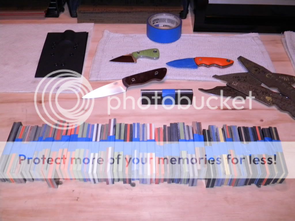

I've been wondering about another aspect of the question of liners, that of thickness. I've always thought thin was aesthetically more pleasing than thick, but am starting to question that premise.
Jon McCargar (jonnymac44) often uses liners so thick they're almost thicker than the scales. His recent "I love to photograph orange G-10" thread in the Custom forum is a case in point. I've been trying to understand why it those thick liners work so well. There is subtle balance in thickness proportions of the scales, liners and tang ratios that pull it together. Color selection--balance, compliment and contrast--must be a factor. Texture, crisp fit and lines obviously play a role too.
Another study might be another recent very cool knife in the Custom forum, Ben Tendick's (BenR.T.) "Caramel Apple Swayback". I absolutely love the knife, but the liners don't quite come together in the same way for me. I can't put my finger on it though. The scales, liners and tang thickness ratios are slightly different. The scales don't taper and thin out at the edges as much. The color compliment/contrast value is different too.
There are soooo many other examples of thickness and color selections. Thin red and/or black liners seem to be fairly traditional, if that's the right word. Loveless comes to mind.
As is usually the case when it comes to style and aesthetics, it is a personal issue, yet there do often seem to be common values shared across a collective consciousness too.

Phil, glad you like the look I'm going for. Without sounding too technical, the balance of the thickness of liner material I use is no accident. I spend a lot of time sizing things up and experimenting to get the "right" look. I agree with you that thin black and red liners are very traditional, which is why I've tried to do something different than that whenever possible. Not because thin red or black liners don't look great, just because I want my knives to have their own look and be unmistakeably mine.
As far as the OP's question goes, I will agree with others....do not waste your time or money on vulcanized/fiber liner material. Stick to G-10 and micarta and you will not have any issues as long as you use your epoxy properly.
