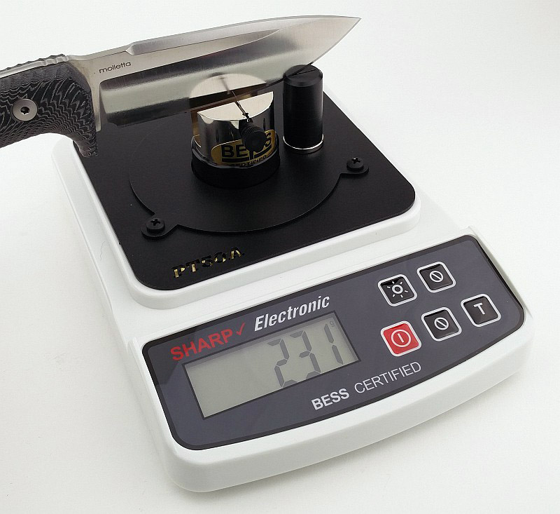

New for 2018! BESS Certified sharpness testing:
The BESS 'C' scale of sharpness, developed by Mike Brubacher (Brubacher Edge Sharpness Scale) will now become part of Tactical Reviews' knife testing process. Initially this will be used to verify the sharpness of the factory edge and allow the knife to be brought to a minimum standard sharpness before testing a blade's cutting performance.
The Lionsteel T5's factory edge has an average BESS 'C' sharpness of 233. This original edge cleanly slices 80gsm copier paper with an edge cut, but won't quite push cut it. It slices into the rounded edge of a doubled over sheet of the same 80gsm paper. It also will catch the edge of green Rizla paper and slice halfway through (cross ways), but not all the way.

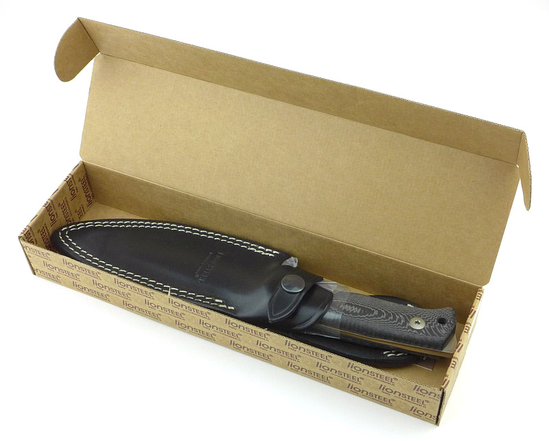

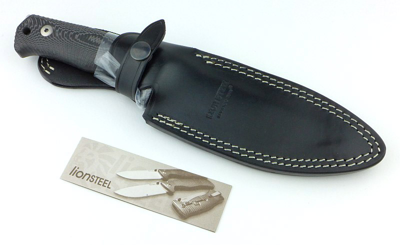

The T5 arrives in a cardboard box.
Inside, the sheathed T5 is otherwise unwrapped.
Along with the T5 is a small leaflet.

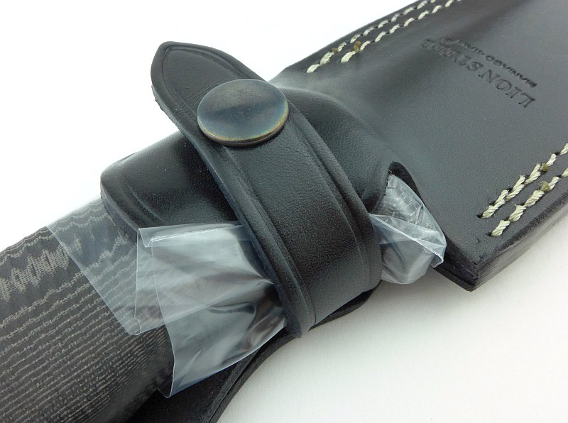

However, the blade is wrapped inside the sheath.
You can see that the plastic wrapping was not terribly successful, as the blade has just sliced through it when it was inserted into the sheath.

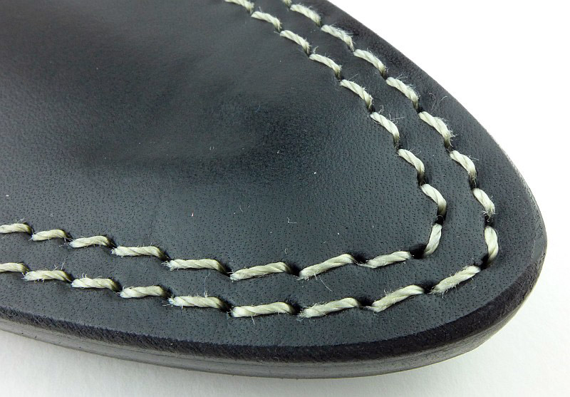

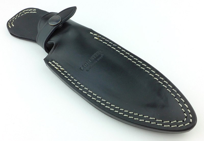

A very nice quality leather sheath is used for the T5.
The leather is double stitched for maximum durability and lifespan.

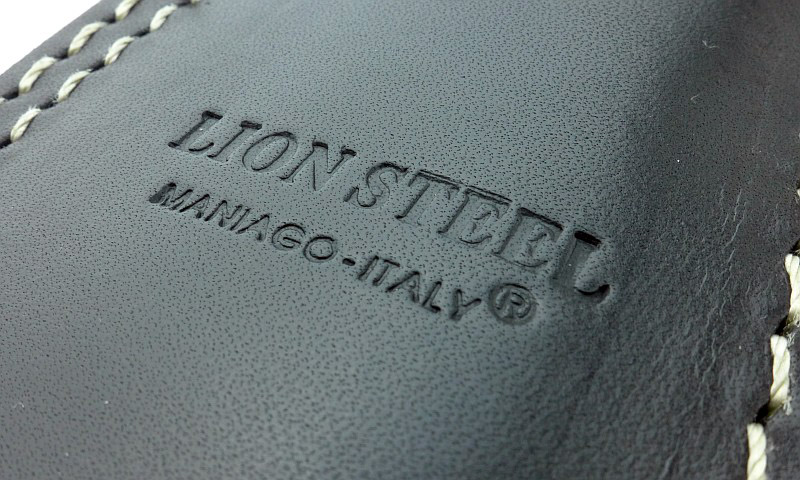

The maker is cleanly embossed into the leather.

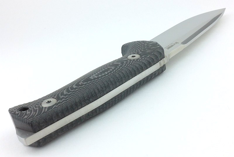

The flat grind is very high, but not quite a full flat grind.
Only visible along the back of the handle, there is a full length, full thickness tang.

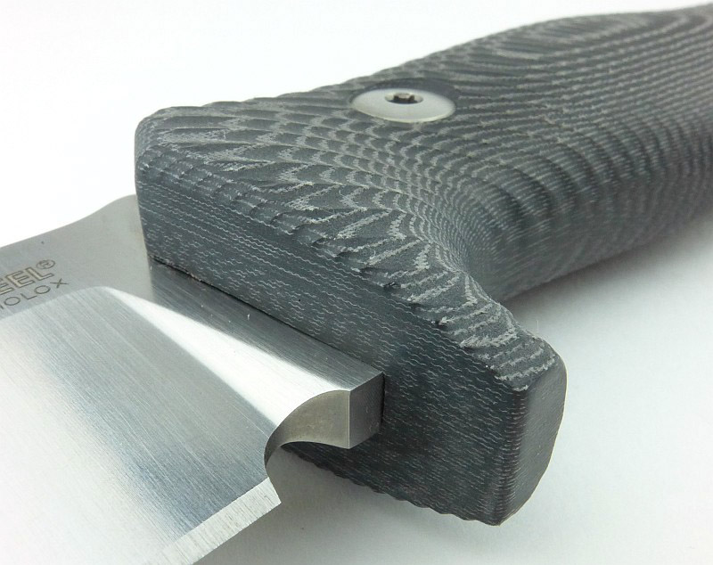

Sculpted from a single piece of micarta, the handle has a wide and comfortable finger guard. The cutting edge is nicely terminated with a sharpening choil.
Grip texturing is machined into the handle surface.
Two stainless Torx bolts secure the handle to the tang.
With a well rounded plunge line, maximum strength is retained.

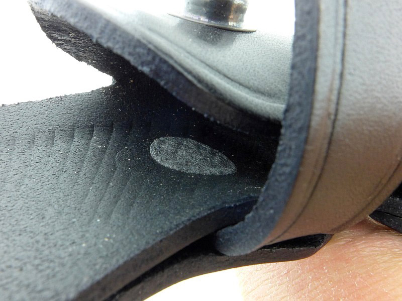

Excellent attention to detail in the sheath with a protective cover over the internal part of the rivets. Doing this prevents the handle being scratched by the metal fixings.
