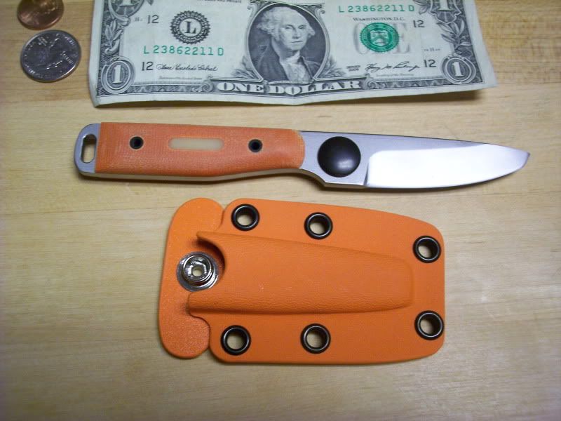

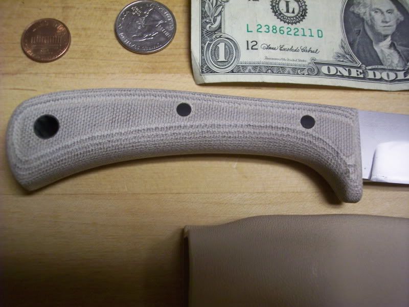

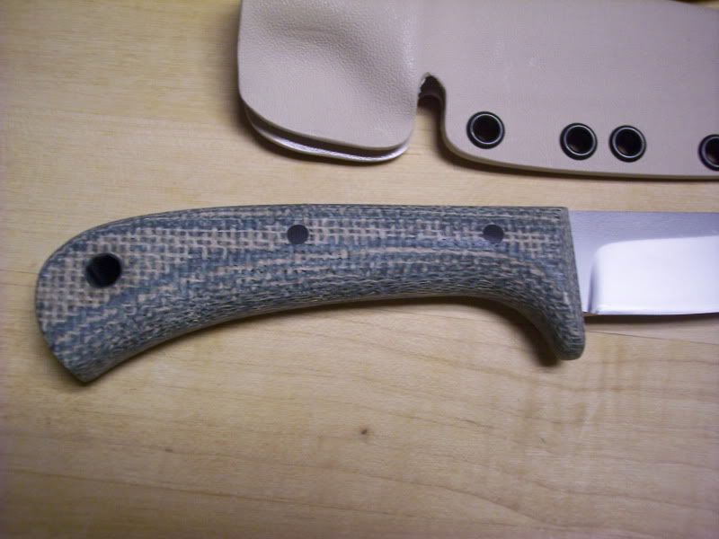

I made my first "mycarta" back in 2006; I call it Lukarta. I've used it ever since then. My favorite is usually whatever I've just made, but really I like the burlaps the best. Here's a few pics of a few of my knives with my Lukarta.
This is my desert linen
Green and natural burlap
And orange with a glow-in-the-dark stripe.
