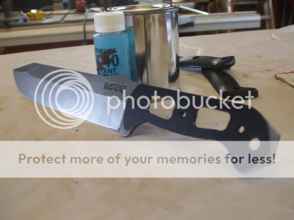

before

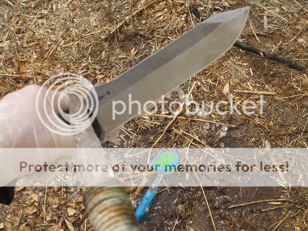

stripping!

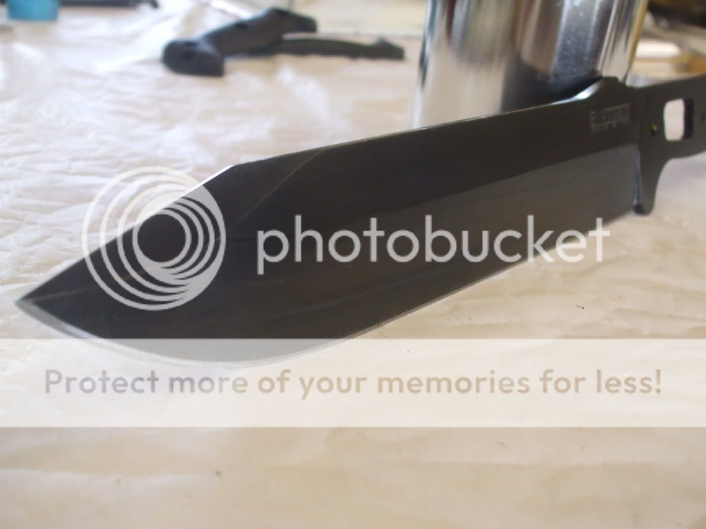

blued up.

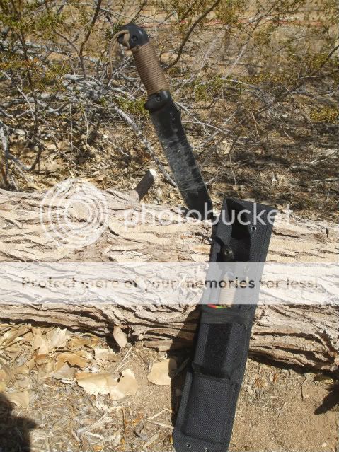

there's more to come(micarta and pouch) but for now, it looks good to me!

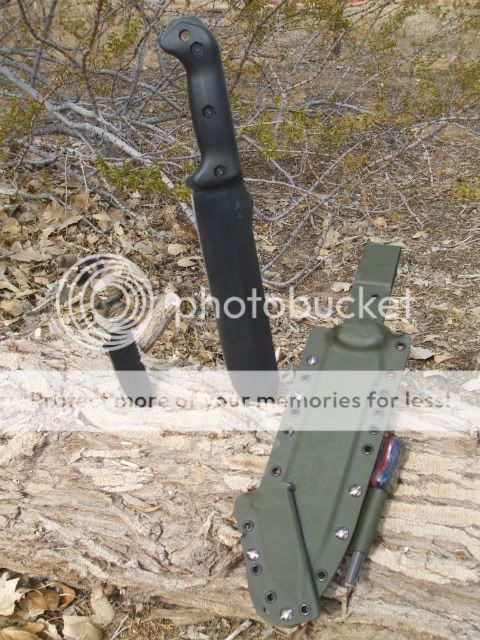

I'm loveing Azwelke kydex!
Very nice man....how long did the process take ya?
Two rounds of aircraft stripper 10 mins. Each. Washed off real good with water. Once over with red scotchbrite and 1000 grit wet dry sand paper.wipe down.44/40 gun blue works instantly. Wipe down with oil. go over edge a little with sharpener , and it was done. I read on this forum about tapeing off under handles and bolt back on and trim around and it worked great to keep factory coating under scales. Wish I could remember who said it to give them credit. 1.5 hrs. Max time

On that sheath, how does the retention compare to the BK2 stock sheath? Same amount of force required to disengage blade?
I would say it takes a little more to get it out. I took it camping and seen grown men that couldn't figure how to get it out,on the other hand I showed my wife , who's on the petite side , one time how to do it and told her it's about attitude when removing the knife and your incharge of it ;use a little snap to get it out and she did it the very first time and totally digs that blade.
