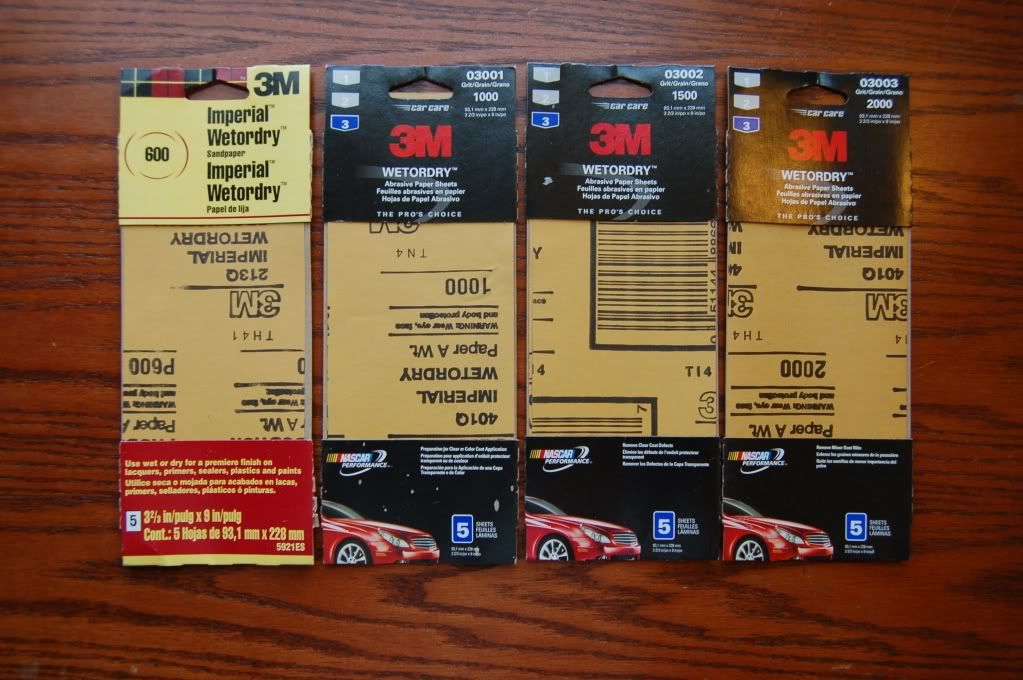

Some wet dry sandpaper, I used 600, 1000, 1500 and 2000 grit, and it worked like a charm :)

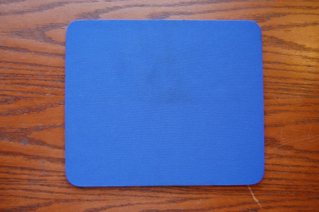

1 regular old mouse pad:

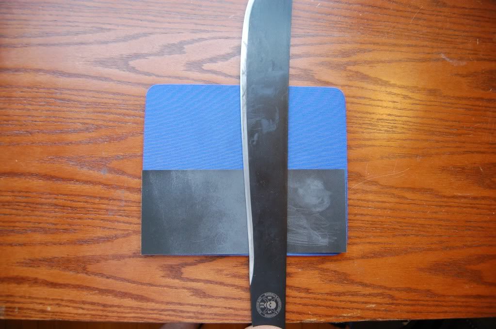

Now you want to place the sandpaper on the mouse pad, and the machete on the sandpaper just like this:

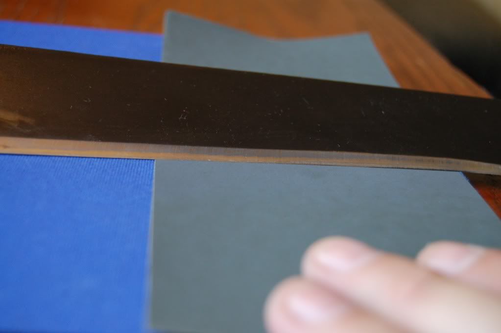

With the machete flat on the sandpaper, lift it up until the edge just touches the sandpaper like this:
Keeping that angle move the machete in a circular motion, while moving up and down the edge of the machete. You do not want to put any pressure on the machete, use only the weight of the blade. You will also have to adjust the angle slightly for the tip area.
The result: :thumbup:

I did the same thing but used 180, 320, 400, 600, 1000, 1200, 1500. I had to go low grit as it didn't arrive with an edge. I tried up to 2000 but it seemed to somehow get duller than when it came off the 1500, so I put it back on the 1500 and left it. I wish I'd read about your circular movement technique before, as I rounded the edge on mine a few times by just going straight across with edge-trailing strokes. I obviously used too much pressure, but it didn't feel like it as I was sharpening:confused:. I eventually got it up to snuff, shaving, in fact, but it took me MUCH longer than your 20 minutes. Add an hour... at least:o. But, like I said, it was a butter knife when it arrived, so I don't feel too bad. It is a great feeling of accomplishment, isn't it? Thanks for the pics and advice.

Why do you need 4 types of sand paper? Do you do step number "Keeping that angle move the machete in a circular motion, while moving up and down the edge of the machete. You do not want to put any pressure on the machete, use only the weight of the blade. You will also have to adjust the angle slightly for the tip area." with each type of sand paper?

I'm so glad you did that. And took the pic of the angle of the edge. So many PPL need gagets, when all you need is an eye for the edge like you just have shown. Great way for a big blade. And the pics will help out new stone users as well. Very well done. Thanks edgy :thumbup:
