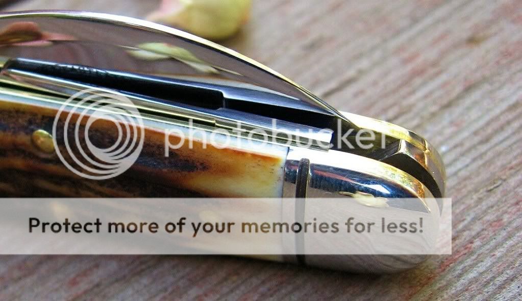

There’s one serious caveat: The point of the master blade sticks out of the handle by around 1/16" when closed; enough so that it can snag your pocket, and it will definitely bite you when using the coping blade. The tang kick comes to a sharp point straight from the tube and needs to be filed down until the point lays below the liner edge, so be prepared to spend five minutes taking care of that if your sample is like mine. I've seen at least three other examples with exposed points.

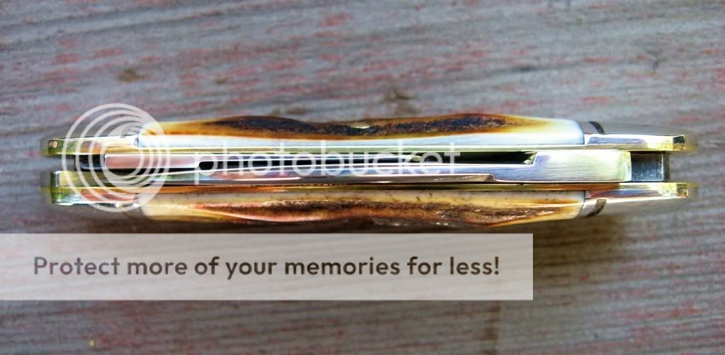

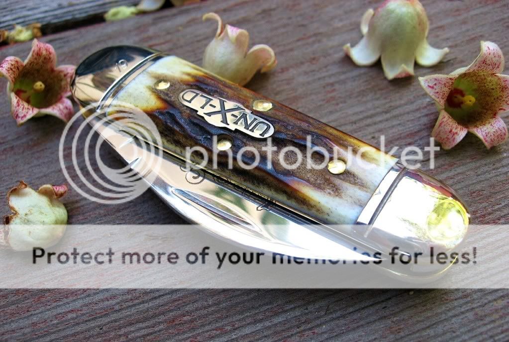

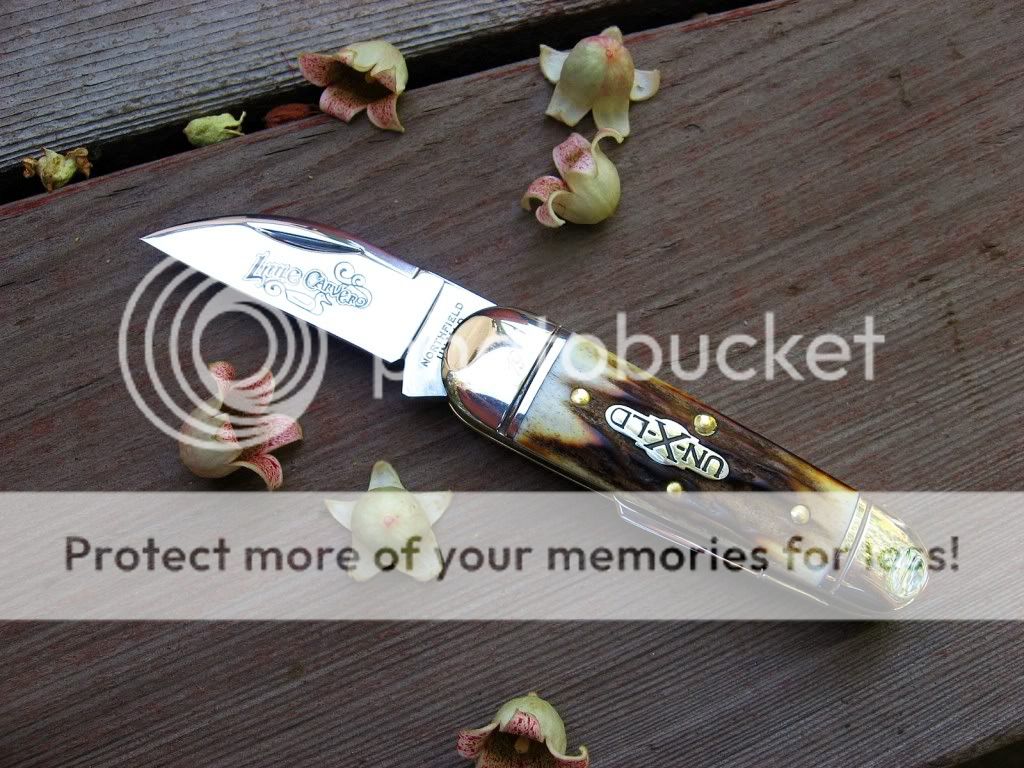

The pics show the knife after filing down the kick:

Ah, c'mon, SS. Your dealer might be able to find you one with a well-seated point, but even if it's exposed, the big ol' kick is hanging way out there where there's plenty of elbow room to work the file without hitting anything. I had it fixed in a few minutes without even bothering to use a vise, and I'm not half as handy as a lot of the guys around here.
Do you have any pics of how it looks after filing? I would be afraid I would ruin the overall beauty of the knife.
Those pics are after filing :D. The kick had a pronounced point before it was filed.
