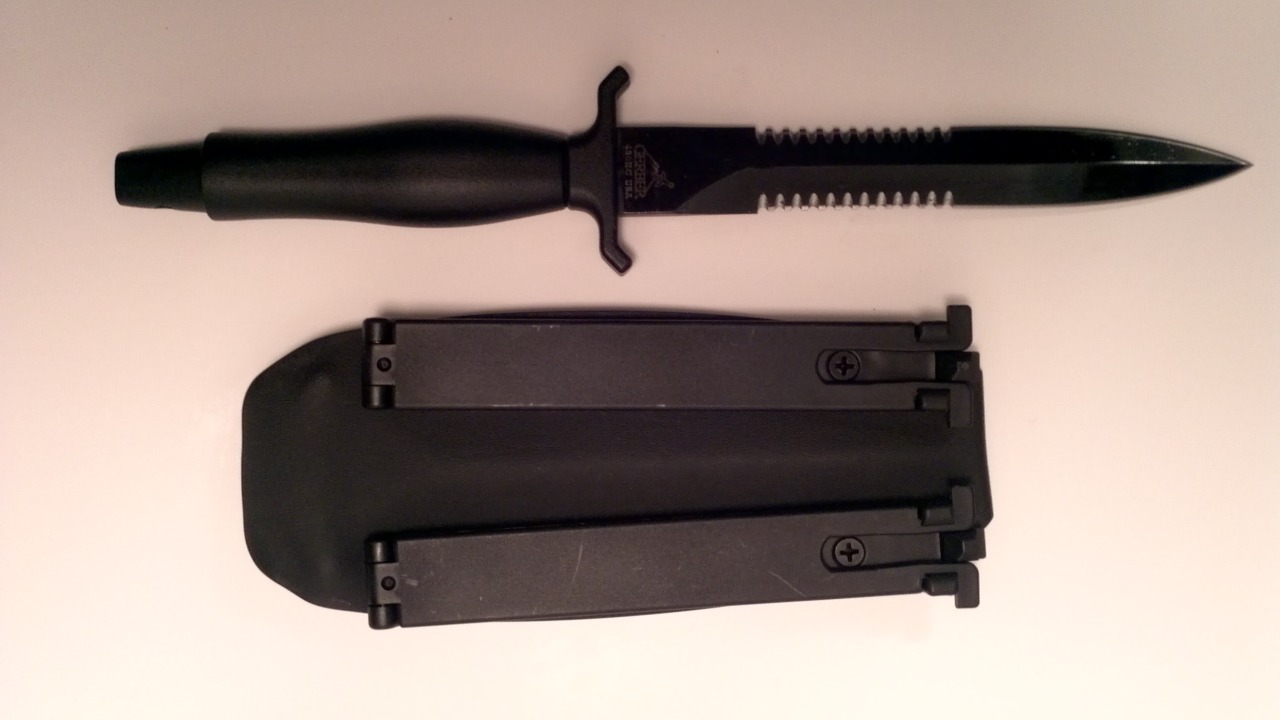

hi every one iv ran into a bit of an issue. see iv been using tek locks for the mounting set up on the sheaths i make. most the knives and sheaths iv done have gone military. just recently i got some feed back that the tek lock wasnt really effective over seas in full gear carries. the tek lock wasnt mollie friendly from what i gathered so to kinda narrow this down with out going on and on. im looking for a mounting set up for use with kydex that has the quick user friendly and versatility belt set up of the tek lock but is mollie compadable
i use leather strap for riggers belts and gen II Molle-lok for molle vests
i do not know if this will be any help ... while back i made a sheath for a soldier who wanted to mount it on his MOLLE, he was going to take it with him in Stan but in the end he took another knife so got no feedback..anyway in order to keep the cost low i made this attachment :
it`s completely removable and and the sheath is large Tek lok compatible
and that`s how it looks on his gear:
i named it poor man`s MOLLE attachment...
