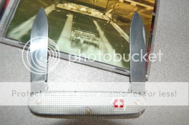

I've been doing a little tinkering. Why? I can't for the life of me find a cigar-pattern Moose that I'd be willing to use.
So, I set to work. Two single-blade Victorinox Solos, handled in aluminum, were combined to make one Moose. Not perfect- little wobble in the blades, little lazy on the snap shut, but I know how to fix that for the next one.
Whatcha think?
These Alox SAK's are really nice folders!
And your moose pattern looks great! :)

You should send these pics to Victorinox for inspiration!!!!!
Well well; I've seen custom handled SAKs before, but never a custom blade configuration! Nice one; I like mooses (meese? Ha ha!), and I like equal-enders, so I see a very nice combo!!
If they make one I'll buy it! I agree, you should send Victorinox a pic!!
I like them, er,, ah,, I mean, it!.:thumbup: Very Cool!.:cool:

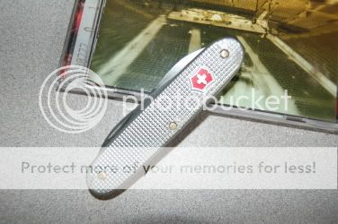

Now to pick up the parts and do a premium one- this one got some warping as I was fighting the pins, but now I know how deep to file them so I can puch 'em out.
One strange thing about this one, though. It has two front sides, two shields. :D
Next one may well have two backsides.

S & S, drilling out the heads of the rivets may make it a little easier for you. It will also give you a place to set your punch.
