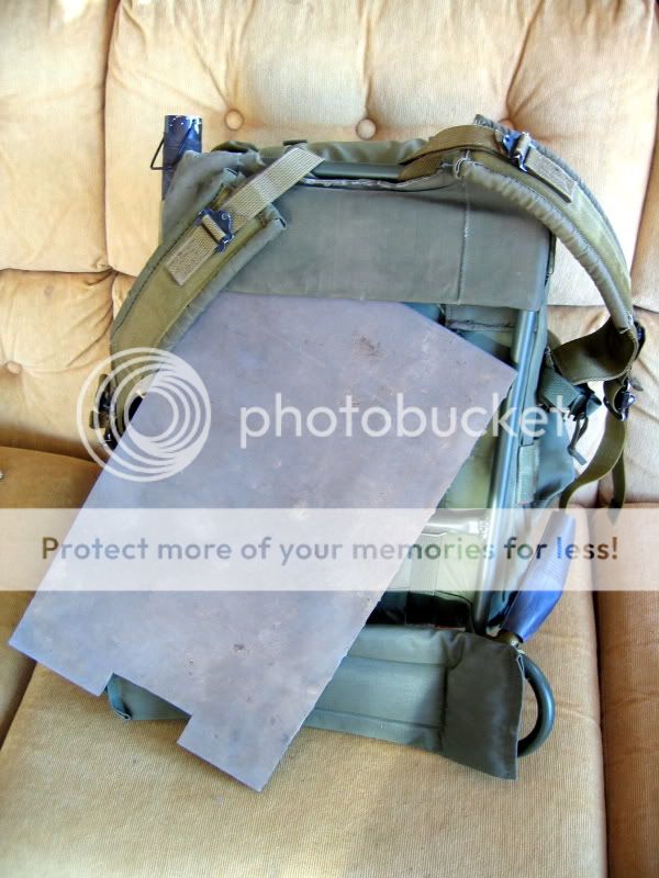

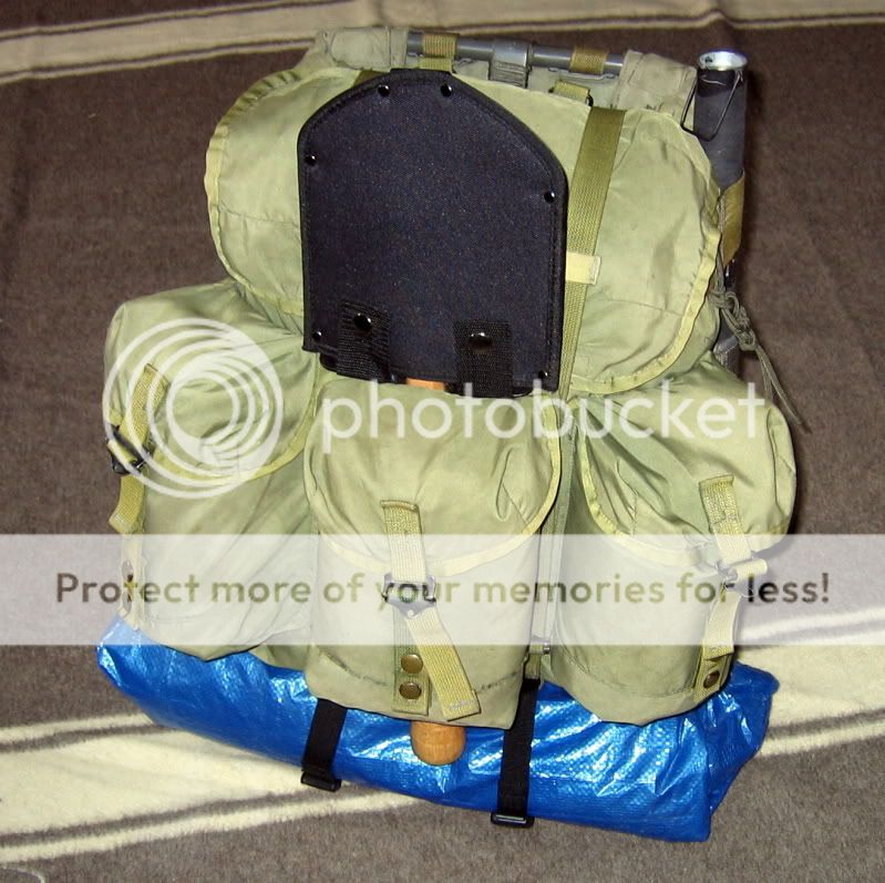

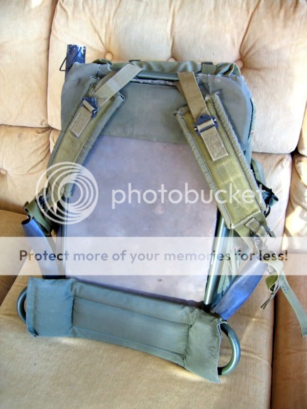

I sport a trusty old Med. ALICE pack for personal reasons (I know many folks hate' em, mine is modified)
Main compartment
-(Fall/Winter) large 15x30 tarp, double layered wool blanket anorak, mitts)
-(Spring/Summer) Hennessey hammock, wool blanket, BDU shirt
-extra clothing in bottom of bag (thermals, socks, underwear, regardless of season)
inside radio pouch
-tinderbag of jute, cedar, steelwool, 8hr tea candles, ferro rod and a butane lighter
Left outside pouch
-32oz Nalgene nested in a Snowpeak Mini Solo cook set.
-food items
Middle outside pouch
-cordage, duct tape, wire
-leather work gloves
-FAK
Right outside pouch
-coleman multifuel gas stove
-bandana
-2 cans of SPAM (mmnnn-mnnn)
Top flap pouch
-4 to 6 large garbage bags
-2 bandanas or a shemagh(sp?)
Strapped to the outside
-hatchet or hawk
-folding bucksaw (tubesaw)
-shovel (Winter)
-a pad of foam rubber slipped between the frame and under the shoulder pad.
-2 lengths of bicycle innertube slid over shoulder straps to use for making ranger bands.
-if I am not training, then I will take a sleeping bag for comfort. (strapped to the bottom)
