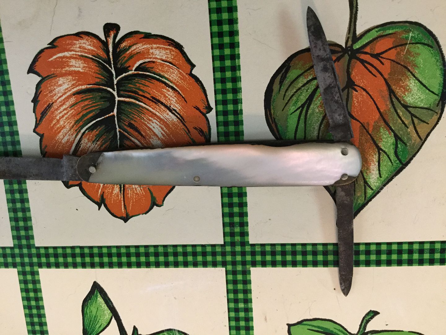

I picked up this rusted and beat up Sheffield lobster knife for $2 for the sole purpose of trying to restore it. Here is what it looked like when I started, the pearl covers were cracked and it was a mass of rust.

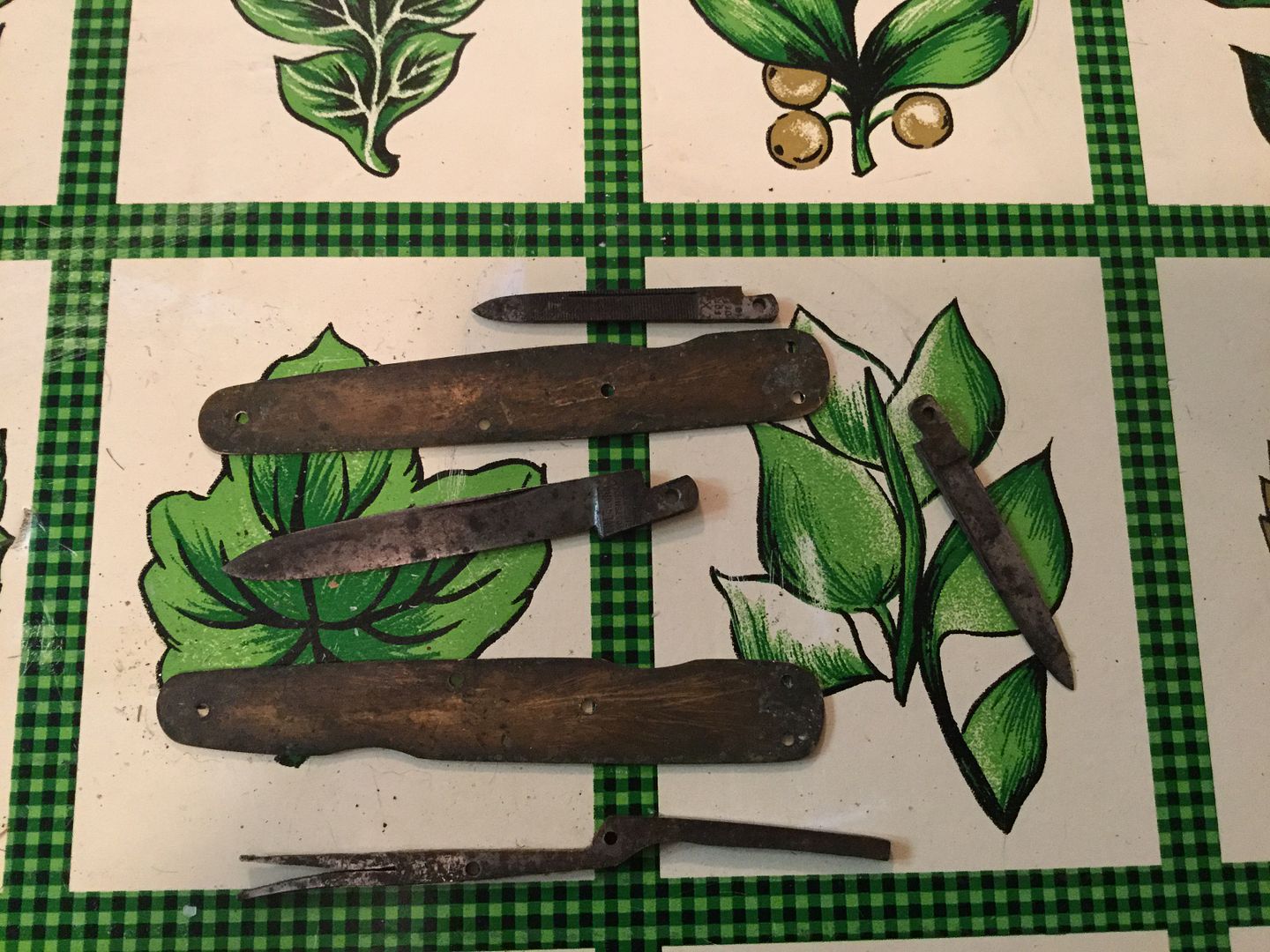

These are the parts broken down, I found the spring fasinating- the pen blade end is actually split!
I forgot to take a picture of the parts cleaned up, but I went with just rust and grime removal with a wire brush and left the patina intact on the blades and spring. I sanded the liners to 1200 grit but didn't go below the majority edge because I didn't want to make them any thinner.

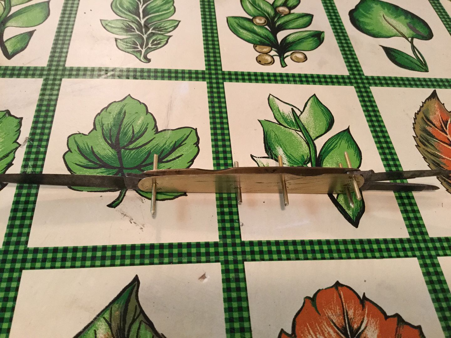

Here it is together! It was kind of difficult to get lined up, but we got there after some harsh words were exchangd:D

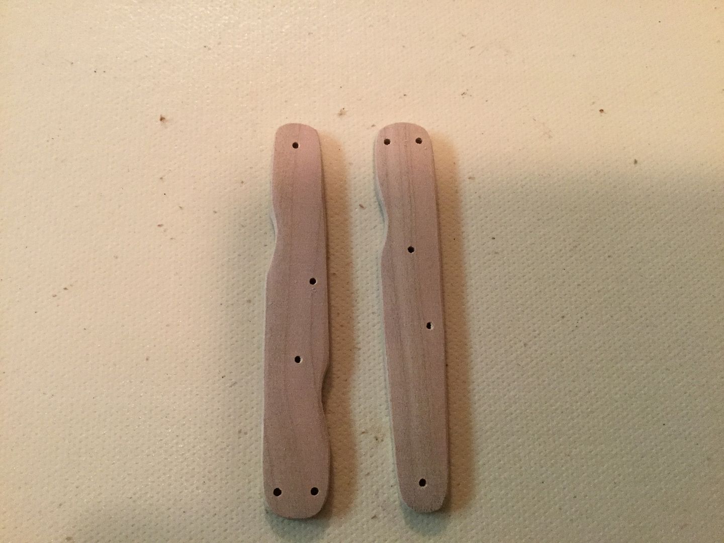

Here are all of the parts cleaned and ready to begin. I went with Cherry wood for the covers.
Right after this picture was taken, I glued the covers to the wrong side of the liners:mad: Fortunality I realized it before the glue fully set so I was able to save everything! It did teach me a valuable lesson in labeling:)
Here are the covers ready to go! I just got a drill press and used it for the first time making the holes, it worked soooo much better than trying to hold a drill steady.
And here it is pinned together! I had some pinning experience from making scales for straight razors, but this was more difficult because of how close together the pins are at the end.

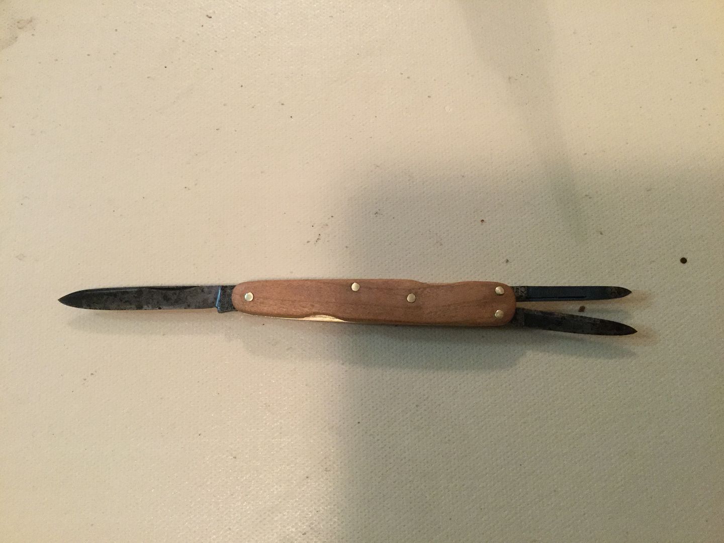

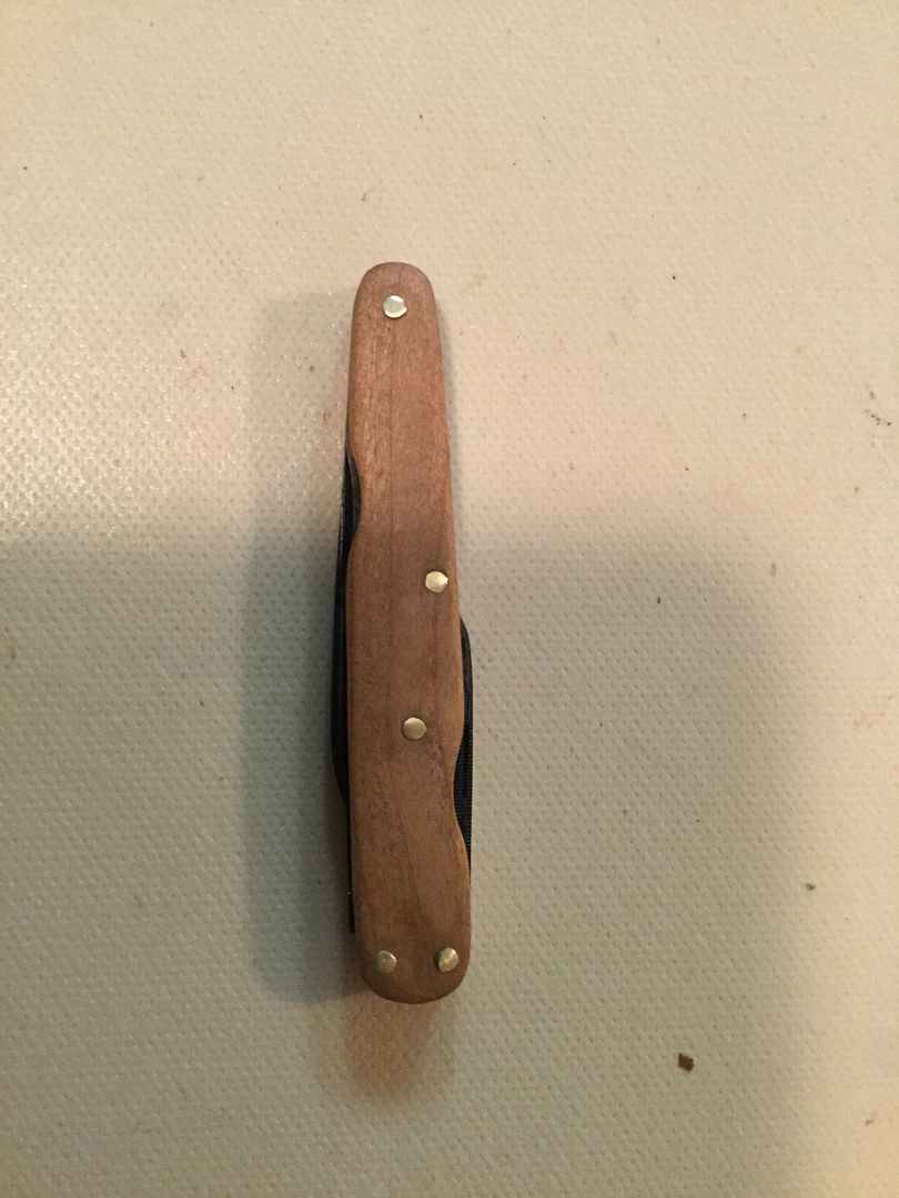

The knife is currently on the porch after getting its initial coat of stain. I will do another coat tomorrow and then it will be finished!
It is definitely not perfect but the walk/talk and snap is good on all blades, which is what I was worried most about.

The urethane and stain was finally dry today, so I sharpened the blades and dropped it into my pocket! I love the edge the vintage Sheffield blades will take:thumbup:
