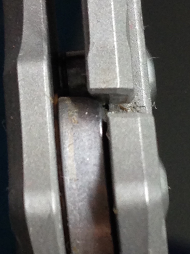

I was looking for some opinions on my small Wilson combat Sebenza.
I bought it about a year ago, not new but like new.
I have only used it lightly over the year.

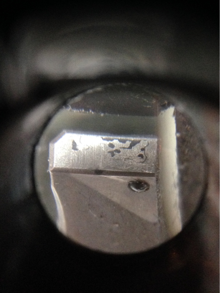

I pulled it apart to day to give it a clean and noticed the heat treated surface on lock bar was flaking off in parts.
Interesting it's not in the contact area but more towards the outside of the face.
I have not miss used it, or flicked it over and over. I have thumbed it a few times but not hard or regularly.

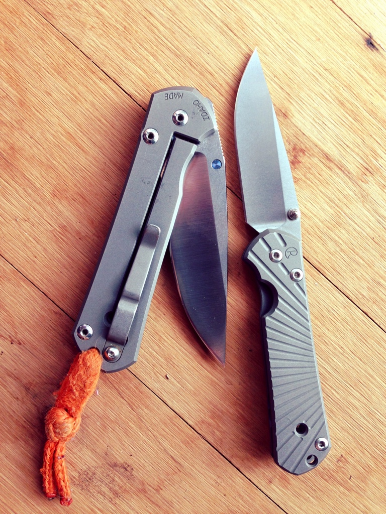

I have a large 21 and it's perfect.

Two questions to ask:
1. Is there blade play?
2. Is the lock sticking?
If yes to one of those questions then there is a problem and you should send it to them. If no to both questions use it and enjoy it. There is some were and tear that happens to a lock face over time but if there is no issue with lockup do not worry about it.
Here is a picture of my old sebenza lock (had no issues)
This is my Insingo Lock that is 4 years old now with no issues. Picture was taken in 2011 after I had it for a year.
Thanks Marthinus ^^^
Maybe it's a little sticky, not much though.
It has a very nice action, with a nice thunk when it locks up.
My concern is it's actually flaking off pieces, I removed a loose piece with my thumb nail. At first I thought it was just a build up of gunk.
I am not sure how thick the flame hardening is, could it just be an oxide layer and not the case hardening?
The flame hardening process they use creates a very thin layer of titanium carbides. The process is a type of carburization. Case hardening is also carburization. They all create a thin layer. It just diffuses carbon into the surface of the titanium and forms nice hard carbides. The surface is very hard and wont wear much so it doesn't need to be thick and you don't want it too thick or it can be brittle.
The process can get goofed up if the temperature or gas mixture in the torch isn't quite right. Or if it is done too long or to short...or if the surface isn't clean....and so on.
It is possible that yours isn't exactly right. If there are no symptoms like stick or play, I'd just keep using the knife. You may eventually need to send it for repair.

The surface flaking off only looks like 1/10'S of a thousands thick.
I have not seen anything like this on Google, has anyone else?
I might send a pic to CR and see what the recon.

Update, I emailed customer service, addressed to Mr Reeve. I received a nice response from Alycia.
Basically as expected, send the knife in and they will repair it at a cost if it's deemed normal wear and tear or free of charge if it's a warranty issue. It will also receive a spa type treatment at no cost.
Fair enough I suppose. I am a little disappointed that my new Sebenza lasted only a year of normal use, more looking than cutting and now needs to be returned for repair. I have to risk shipping and the cost of a repair if considered normal wear and tear. I personally think it's a defect in the case hardening as it is too thin and brittle, lacking the toughness required to withstand normal use, I am confident CRK will acknowledge this.
