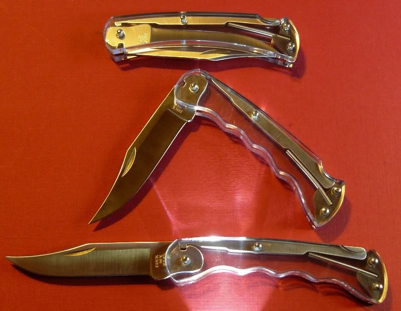

My understanding is that lock rock comes from four primary places.
The first is a design issue related to the angle of the faces on the blade and lockbar where they meet. If you look closely, you'll see that the face where they meet is not quite vertical. Hard cutting forces will "rock" the front of the lock bar up under hard cutting. (Aside: Cold Steel's Triad design puts a stop pin there, which eliminates this. Would be nice to see Buck incorporate that design.)
Second is a poor fit between the blade's indent and the lock bar face as byond described. Spyderco's Sal Glassner claims that use of more malleable fine-blankable steels for blades and lockbars contribute to lock rock. Over time, the first mode of rock can cause the second as the lockbar face deforms.
Third is worn blade and lockbar pivot pins. Several Buck mechanics have reported on this forum that replacing the lockbar and pins usually fixes the problem.
And a fourth cause is when holes that the pivot pins sit in deform or are too big to begin with. Buck has said the plastic framed lockbacks can open up over time and as many have reported, the heads of the blade pivots on the Spitfire/Slimline models will visibly move in the frame sometimes.
