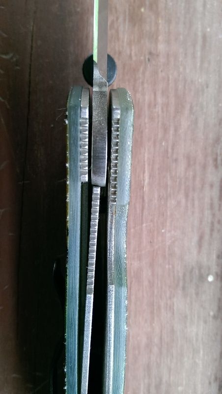

Hey guys, been massively busy as of late. Hope yall are well.
Ill try to keep this quick. My 2012 CQC7AW has had lock slip ever since i got it. Happens under firm hand pressure, which i periodically use to test my blades. Ive cleaned the tang, and even slightly sanded the contact faces. The problem will seem to go away, but slowly comes back. Ive disassembled the knife as well. No permanent fix. Lockup is between 40 to 60 percent, depending on the knife's mood, and the liner spring, when disassembled, has plenty of overtravel to cover the rest of the wear. Hope the above makes sense.
Ive studied EKI's website, Bob Terzoulas book, and everything else on liner locks i can get my hands on. There is no physical reason this lock should slip EXCEPT ONE: My lock face angle is too steep, thus forcing the liner towards disengagement when pressure is applied. This is all i can think of.
The angle of the blade tang on linerlocks should be around ten degrees-ish, depending on the knife. My commander's is roughly 12, with no problems. ALL my other solid knives are like 8. The CQC 7's is more like 17. This seems WAYY too steep, and likely the cause of the liner spring slipping of the blade when force is applied. You dont need to be an engineer or knifesmith to figure that out.
(And for the love of God, I AM NOT REFERRING TO THE THREE POINT INTERFACE angle Emerson talks about on the website. The angle i am referring to is NOT DESCRIBED there).
I wont go into my standard rant or the reasons i am opposed to sending it in. But i would like to ask a favor:
Please measure the blade tang ramp angle, when looking down at the open knife, edge facing up at you. Ya know, like youre looking down to check lockup. That angle. Plz only CQC 7's. Pictures would be a plus. Id like to actually SEE what the average angle on your WORKING 7s are.

The tang angle on both my 7s is around 8 degrees.
Slight stick, no slip.
Lock slip is dangerous especially if it can happen with hand pressure alone, and knives like that should not pass QC especially if the issue is as visible as the tang angle being several degrees wider than the norm.

Jamesh, sounds like your right about the interface on the blade. I was recently sent a couple of pimped knives with the same issue. I was able to sort of fix one by filing the interface of the lockbar square and redoing it's "bend" closer to the blade so it's a better/tighter angle going into the blade's interface. The other was all wrong as a near new/mint liner from 2 others slipped immediately with minimal effort. It needs to have it's blade interface redone if allowable or a new blade since the blade is always at fault. Sorry to hear of such issues! I hope it gets sorted out quickly and easily for you by EKI.

If you can take a pic and email it to me at my user id at hotmail.com I will post it up for ya.
Dr.
Thx for the pic. Mine is DOUBLE that.

Appreciate the gesture. Pics sent. It doesnt look as extreme in the photos, specially the one showing the lockup. Measured it again and its between 15 and 17 degrees, give or take.
