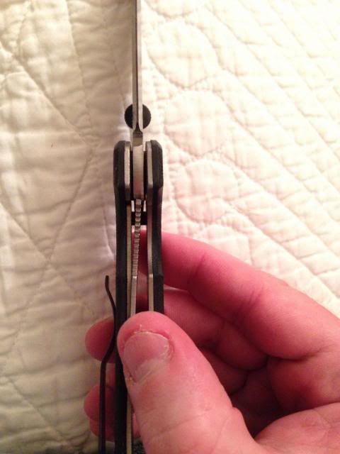

So I am sort of new to Emerson's and I just got a mini horseman in today. Fit and finish look pretty great. Centering is near perfect and lock up is early. Thing is I am just wondering if it is normal for the lockup to be a little more towards the center (maybe 45-50%) when waved hard out of the pocket. If opened easily or lightly waved open it is early within the first 25%, but a hard wave will put it like I said at about halfway over (midway on the engagement tang). This normal? Also it is really sticky when opened hard upon closing.
Engagement sounds normal to me. As for the sticky lock, you can let it wear in some more, or you might try a little graphite from a pencil on the lock face.

Lock up sounds normal to me. You will get tired of the novelty of wave opening and this is a good thing. Your pants pockets will thank you. Yes, a little graphite will help with the break in of the sticky liner lock. Keep the chisel grind sharp with frequent stropping.
Waving a knife open exerts a lot of force on the stop pin and it's normal for the lock to slide over a bit more and engage deeper. I tend to keep my Emerson knives a bit on the tighter side so they only open with a purposeful movement. I can still wave them open in an emergency, but I tend to just be low key and don't advertise my uber skills. ;)

So I tightened up the pivot some and it is harder to deploy now, but if I shake it semi hard it will still shake the blade out. So this is still normal for Emerson's?
How is the lockup when you open it normally? Is the lockbar still sticky if opened that way?

Yes, tightening the pivot will do it. That would be alternate mechanical function. If you can shake your knife and the blade falls out, then I would say that yes, you may benefit from tightening the pivot. If you have some problems with the detent, then you should be ale to send your knife in for a tune up (return the Emerson). The reason your lockup is so late is because the pivot is too loose. Pretty common occurrence with most liner locks from just about every manufacturer.
I tried to tighten the pivot and now it is difficult to deploy, but the lock up is still late like the pic.
Hmm, you can tighten it incrementally. What I usually do is try to dial in the pivot so it doesn't move too easily, then I turn it slighhtly back to allow the desired tension. Make sure your handle screws are tight, but not too tight as to strip or break the screws. If you can't tune it to your satisfaction, maybe consider sending it back for service.
