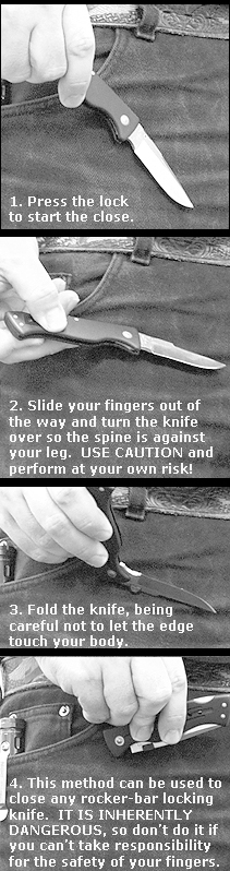

You can close any lockback by unlocking the blade with pressure between the locking bar and frame and pushing the blade closed on your leg. Keep your fingrs clear of the blade's path.

I did a photo sequence for the leg closure:
