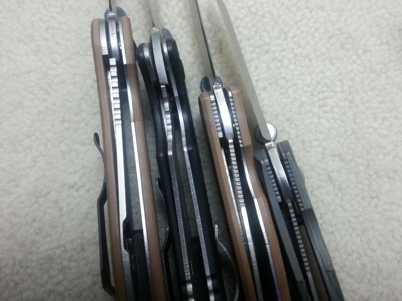

Here's 4 that I have with different degrees of lockup:
The first one on the left is the A136 that I just got. I opened and closed it until it developed some stickiness, then disassembled it and wiped down all the pivot & washer surfaces and put it back together dry. It's silky smooth now, and will usually remain that way like my other Emersons, unless something gets in the pivot area. The lockup is still as when I first got it, and very early where the full thickness of the lockbar hasn't fully engaged. I expect this to settle in over time and move farther to the right, as it gets used.
The second one is a Journeyman that I am the second owner of, and I've used it a lot. The entire thickness of the lockbar is fully engaged, and has stayed this way. BTW, the way I determine the degree of lockup is where the leading edge of the lockbar is on the lockface (0% being no lockup, and 100% being all the way to the end of the lockface ramp). I'd say the Journeyman is at around 40% looking at it dead-on.
The 3rd is a 7V with the new, thicker linerlock which is fully engaged at about 30%.
The 4th one is an older 7B with the thinner linerlock which is also fully engaged at around 40%. It's had some customization done, but not because of the lockbar.
All of them except for the A136 (since I just got that and haven't really used it), have had their lockbars settled in, for the most part. They haven't moved any further.
Personally, I like the lockups in your first two pix. The tan Emerson in the last picture is the one I'd be "working" some to see if I could get it to settle in a bit farther over. Same with gooeytek's pix. That new A136 on the left is the one I'd want to settle in some more. The others all look great to me.
