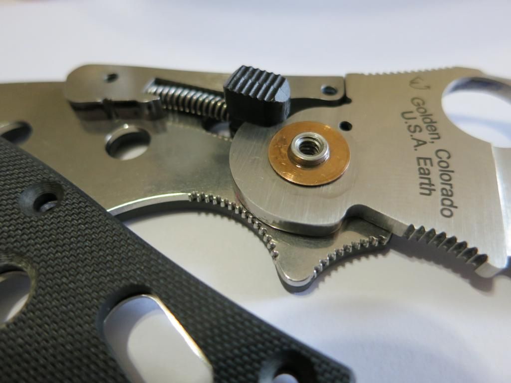

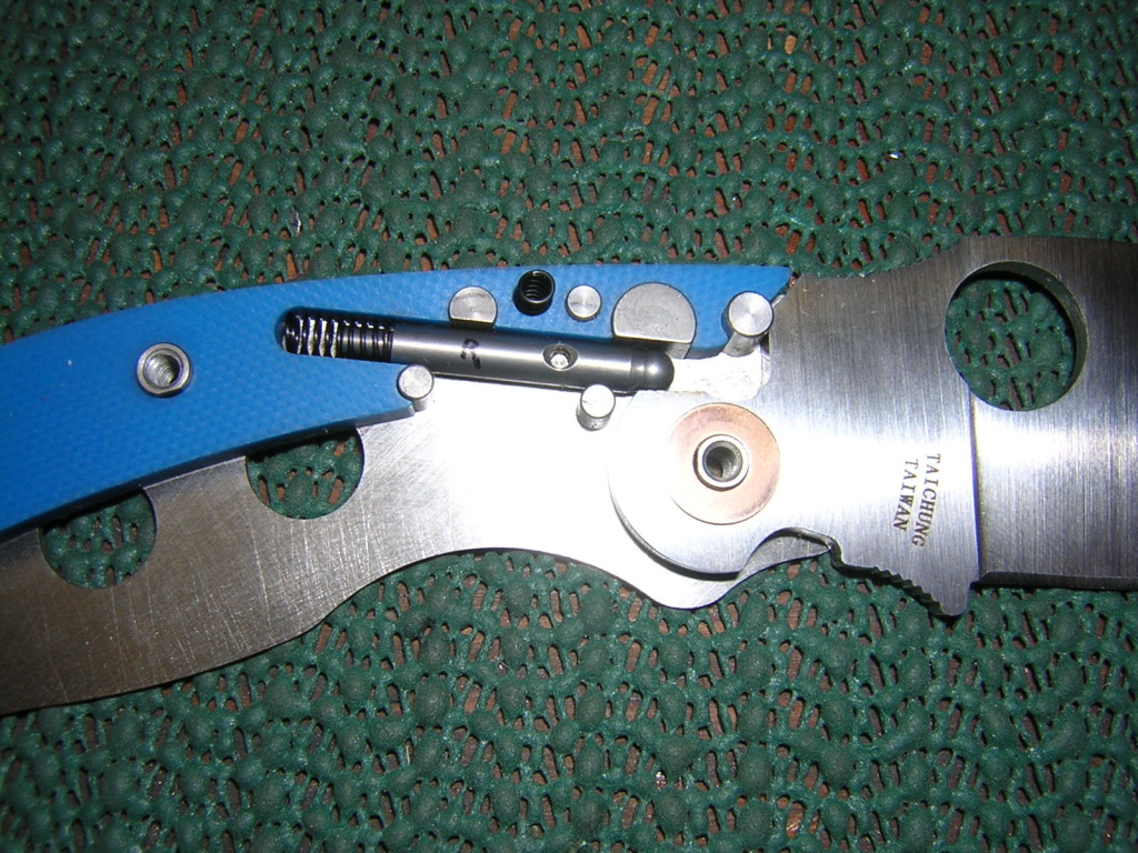

That is pretty much the Bolt Action Lock.
Google Spyderco Sage 3, scroll down and you will ser pictures.
That lock is very close to my solution . How compensate wear on parts I can't figure ?
Yeah, it's only been about 5 years...................
Yes, it's been about five years. I'm glad they made it. It means that my idea was good then .I come to that just from looking in Tri-ad lock . What i don t liked then and now on knife with Tri-ad lock is disproportionate proportion of blade/handle ..
