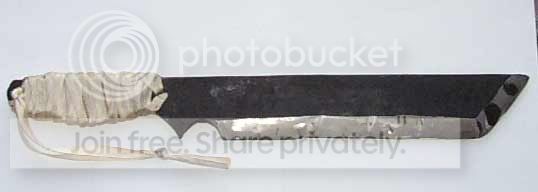

If your going to split logs you need a large heavy blade and other than Busse you want find many production knives capable of log splitting and at the Busse price you might as well go custom.
This one here is 18 inches and 4+ pounds and can really split a log.

What the hell is that thing in your pictures?? Four pounds?!
What's with the holes in the blade?

This monstrosity was created by my brother out of his love for big bowies but hatred of the cheap pakistani/china POS's out there that break the first time you use them. It's 18 inches long and made out of 1095HC at 1/2inch stock. The holes were put in to lighten the weight. I have done some chopping with this and the holes have not affected the blade strength at all but then with 1/2 inch you don't really need to worry to much about spine strength.
My personal opinion is that it's ugly:barf: ( looks like something the Creeper would cary from Jeepers Creepers ) but then I'm not a real big bowie fan and I figure to each his own. It will however kill a log:D . The thing is a bitch to sharpen.
