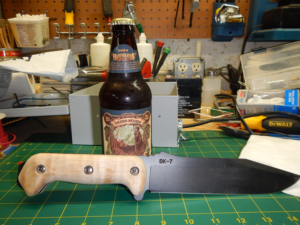

Ha! I did the same thing....clicked on here thinking I would see some progress. I'm going to try and pull myself away from cleaning my §h!+hole basement and do some electro etching on my 12 with my new etcher I made the other day. Probably going to have to finish the Ruthless Rye I'm drinking and start another one before I can lose my inhibition of responsibility...
This is the brew, with a knife that needs no etching:
And the complete etcher, built out of a 12VDC power supply for the alarm industry:

Looking forward to seeing the 12 etched, but more interested in seeing your electrical box of magic in action.
