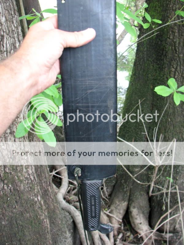

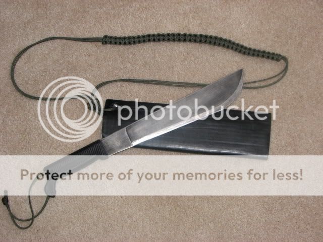

I made this one about four years ago. It's made from PVC pipe, heated and pressed, like kydex. I made a paracord baldric for it. I took this pics when I finished it, and I'm still using the same machete and sheath. Used it today as a matter of fact. The sheath doubles as a cutting board. It has held up to some heavy misuse. The fit is still tight, it's not going anywhere unless you pull it out.

How did you heat the PVC?
I boiled water in a tall pot and put the pipe section in there. I read that you don't want to heat it too much or it'll burn the pvc. Boiling did the trick for me, but I had to flatten it quick, because it did cool down fast.

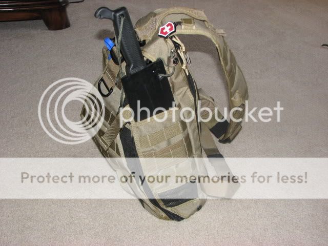

Fishshooter - I like that idea of a drilling a hole through the corner. I was never happy with how to strap it to the pack. Never thought of that! :thumbup:

The PVC pipe sheath is a great idea for machetes. I will make one for the ATV, and my neighbor will want one for his too. Thanks for the great tip fishshooter:thumbup:
I've got a few holes in mine now. Sometimes I'll wrap some cordage around the sheath, or piggyback a BK11 on it, and I use the other holes for attachment points.
I carry mine vertically on the side of my pack like fishshooter. Knife on one side, axe on the other side.
