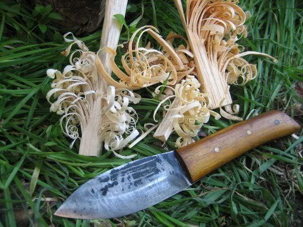

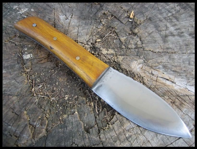

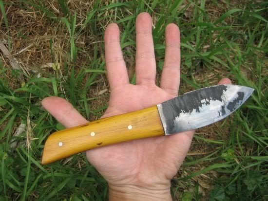

Hope this helps. My first trip to Peru was with a Nessmuk that had osage scales on the 01 blade. It spent lots of time outside of the sheath in the rain. The humidity was pretty bad. It was used hard and to this day no problems at all!
-RB

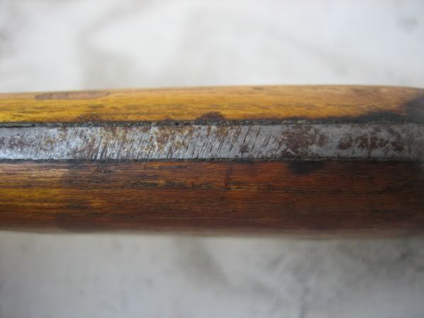

Before
In Peru
After
