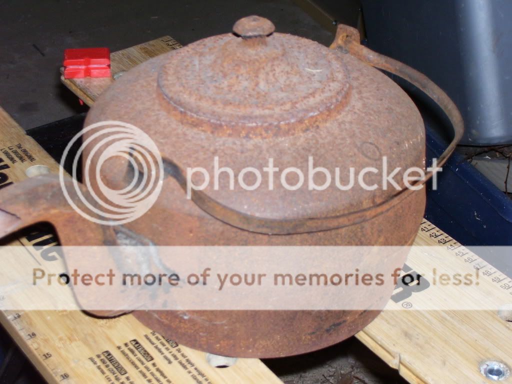

He was rummaging thr one of his old barns, trying to decide which to use for storing wood when he dug this out of a pile...
It's cast Iron !! It's probably as old(if not older then) as his house... It needs a wood dowel for the handle and needs cleaned up(a lot)... I picked up these 2 tools for helping with cleaning it along with steel wool.. They are both brass wired so not to trash the designs on the kettle...

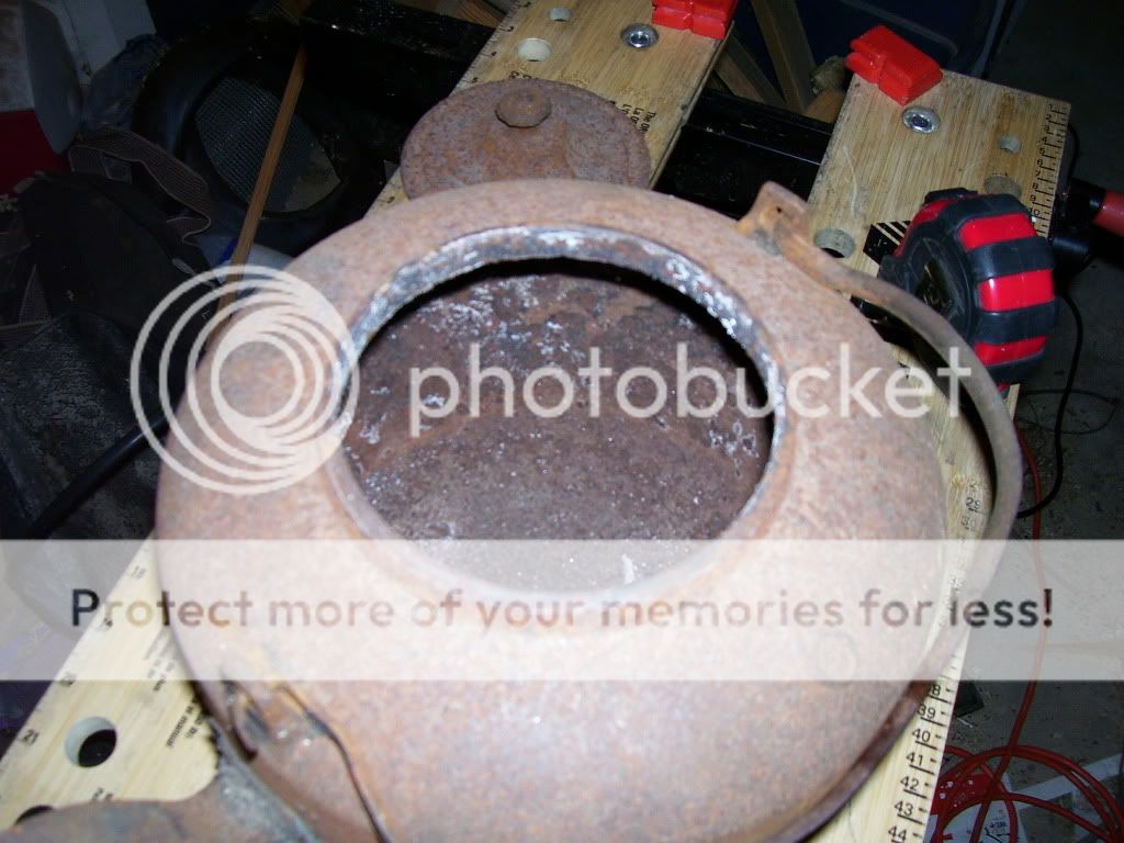

I know it'll need seasoned and all, but my biggest concern is this... Once I seasoned it, I planned to use it as a humidifier, on my woodstove.. Once I have it seasoned, should I add oil to the water with each fill to keep it seasoned, or will the one time do the job, and if I do have to add oil to the water, with each filling how much should I add ??

Try Jasco prep-n-prime its a chemical that converts iron oxide (rust) into iron phospate, it will turn it black, just scrape off the loose scale first, as long as your not going to use it to drink from, there is also a spray paint called Rust Converter, just scrape off the loose stuff and spray, I found a large cast iron caldrun in worse shape then your kettle and it looks almost new. You can find either one at Lowes.

I heat entirely with wood, and used two cast iron kettles for humidifiers for several years. They rust like crazy, regardless of what you do to them. We switched over to the porcelain (sp?) coated iron, and found that they must have a thorough coating in order to work, otherwise they rust as well. We eventually switched over to some large aluminum pots (3-4 gal) that were bought in a Korean food store. We could not use the water from the cast iron, but it was fine from the alum. Also, we only filled the alum pots every other day as opposed to the two to four fillings per day with the iron. All this is done on a cast iron stove.

If I was going to drink from it, I'd blast the rust off with a light garnet media. Then coat it in vegetable oil (or olive) and bake it. Two or three bakings would give it back that cast iron sheen and be great for preventing any rust. Make sure you never use steel wool on it.
I forgot to add this. When I needed to clean my kettles, I sandblasted them. This takes about two minutes, and they come out looking like new, It will not hurt them.

Well since I can't use steel wool on it, I'm assuming the brass is safe to use... Wish I had access to a blaster but I'd wana be careful with that because there's some sort of pattern on the lid that I'd like to preserve if possible... This should be a fun little project ...

I remembered an old trick for refinishing iron that works like a charm. DO THIS OUTSIDE!! Wear goggles, gloves and stay away from the fumes.
First, clean off all loose debris and wash you pot thoroughly. In a five gallon bucket, add water until you are a little more than a gallon shy of the top. GENTLY pour in a gallon of muratic acid (the stuff from the pool supply section at Home Depot or Lowes).
Tie a rope or wire on the lid, and the pot itself and lower it in. It will turn colors, fumes will escape (which quickly dissipate) and it will bubble. The acid will attack the rust, but leave the iron alone unless you leave it in solution too long. I leave my yard sale finds in for about 30 minutes, then check them. Pull them out with the rope or wire and hose them off and inspect carefully. You will see pits were the bad rust was, but where there was is surface rust it will be gone, or at lease partially so.
Some of the pans I have left in for a couple of hours after checking, and my favorite grill pan required that I make another batch of solution to get all of the rust. When you are satisfied that you have most of the rust, rinse the pot to get off all the acid. Finish cleaning with a stiff brush and sink cleanser. Scrub it good.
You may have a few spots to work on with a small brush, but I leave them on as service marks. Don't use sand paper as you will see grit scratches when you season the pot. The iron will be colored by the acid, and come out a natural gray. Since to this point the acids in the muratic acid are both water water soluble and you can wash off all the cleanser, you can use this to cook with at this point.
Season the pot as you would a cast iron pan. You should know that it will start rusting again immediately inside if you use it to boil water. Oil will not help; it is iron exposed to water. Worse, if you live in an area like we do, your next job at the end of the season will be to clean out a couple of pounds of calcium buildup.
