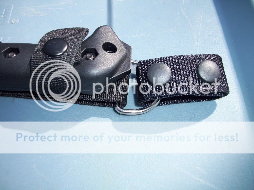

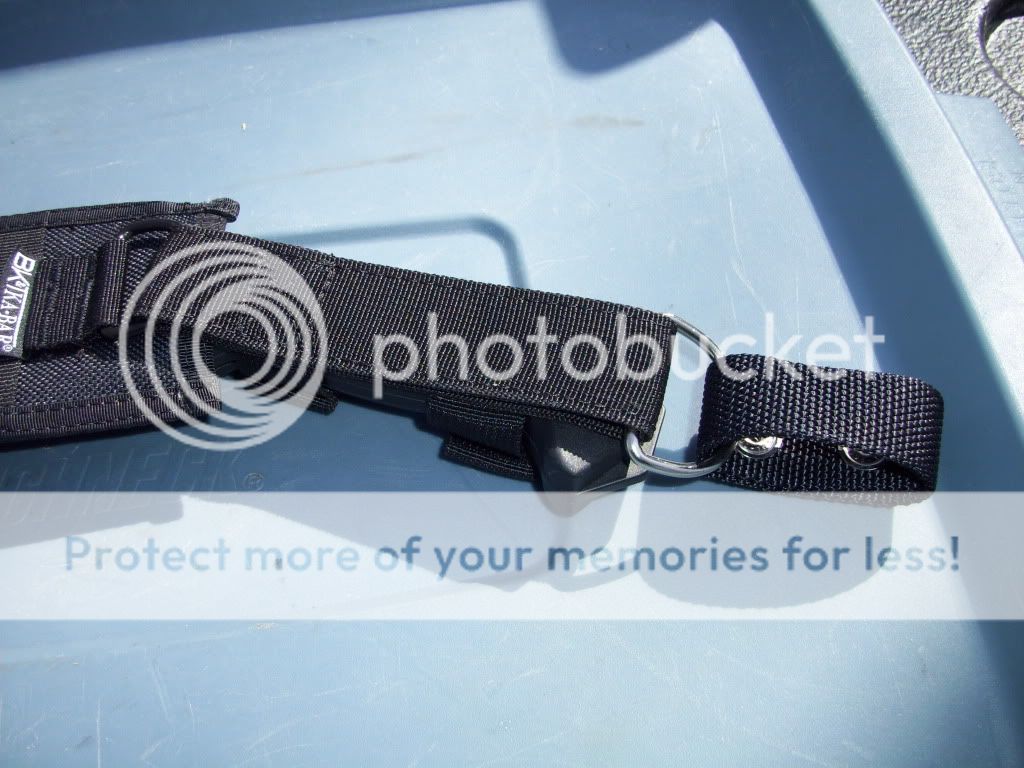

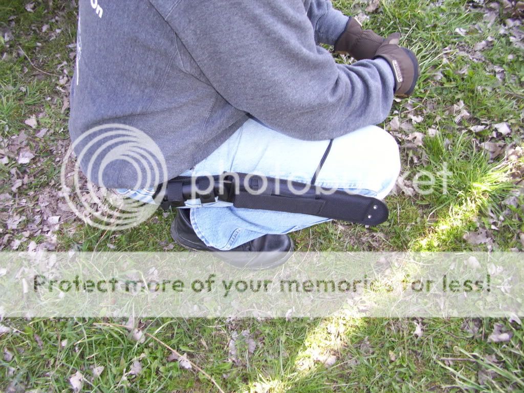

To make the factory sheaths MUCH more versatile & user friendly, this is what i do to almost all my stock sheaths:
Go to a police supply store or your local gun store & buy a pack of 4 Belt Keepers (that is the black double snap thing that holds the swivel to your belt.
Go to your local hardware store & buy a couple pieces of 3/16" rod. Measure, cut & bend your own D-ring.
Use some type of cordage for a leg tie. By doing this (making your own drop-leg-swivel set up) you make large knives 1000% more easy to carry aal day long, working , getting into/out of vehicles, atv, horses & makes it easy to work, squat, sit, bend & reach, without it poking you in the side, etc....

That's a great idea, I might just end up rigging my sheath that way. I'm in agreement on the sabre grind as well. That's why I chose the Junglas over the RTAK II. But seeing as how it will be my back up survival blade, I would rather sacrifice the strength of the sabre grind for the lightness of the full flat grind to make it easier carrying both. I find it pretty unlikely that both blades would crap out on me during a the same trip. Also, the full flat grind shears better. That's another plus to defensive capability.
